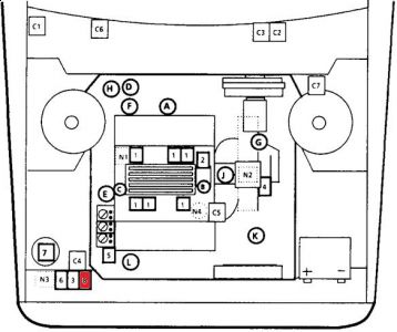

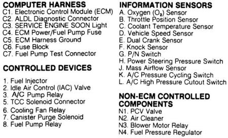

1992 Buick Lesabre 6 cyl Automatic
I want to change my fuel filter but I can't find my fuel pump fuse to remove the pressure in the lines. I've checked in the Haynes manual and I still can't seem to locate it.
Sunday, March 22nd, 2009 AT 1:45 PM
ZACKMAN
  • 4,202 POSTS
Instead of a fuse, it is a relay. Located under the hood. (Highlighted)
