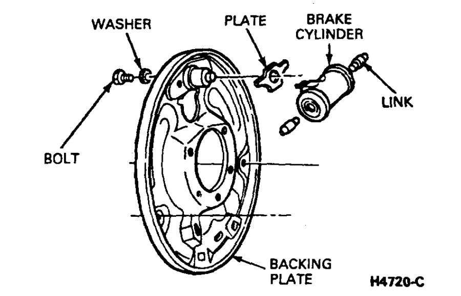

Rear wheel leaking fluid how can I fix it

Check the brake line at the wheel. If that is okay, then remove the wheel and drum and inspect the wheel cylinder. Check out the diagrams (Below). Please let us know if you need anything else to get the problem fixed.
Image (Click to make bigger)
