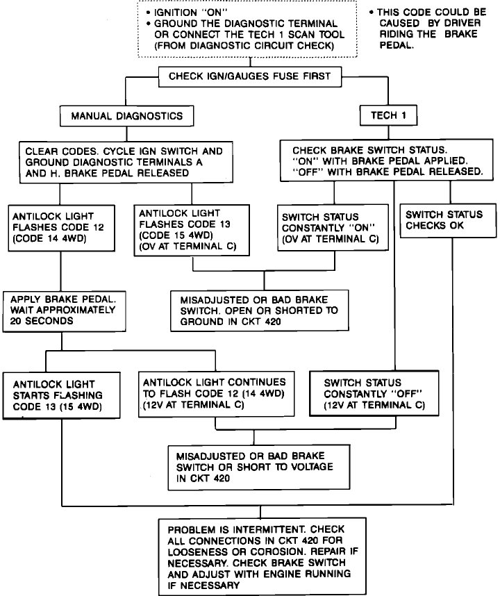

The brake light is giving me a code. It flashes eight short times then one long time, over and over. What code is this trying to tell me?

Follow the diagnostic procedure on image below. Hope this helps and let us know what you find please.
Image (Click to make bigger)
