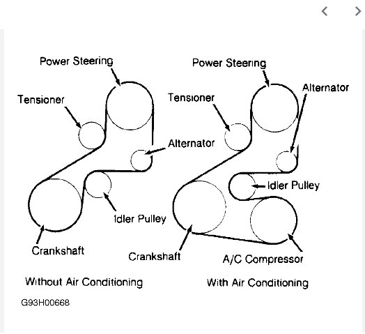

I need the serpentine belt diagram?
CRL8390
MEMBER
1993 GEO TRACKER
4 CYL
2WD
MANUAL
200,000 MILES
I need the belt diagram?
Tuesday, September 24th, 2024 AT 11:08 AM
KEN L
MASTER CERTIFIED MECHANIC
55,266 POSTS
Here you go!
https://www.2carpros.com/diagrams/geo/tracker/1992
Check out the images (below). Let us know if you need anything else.
