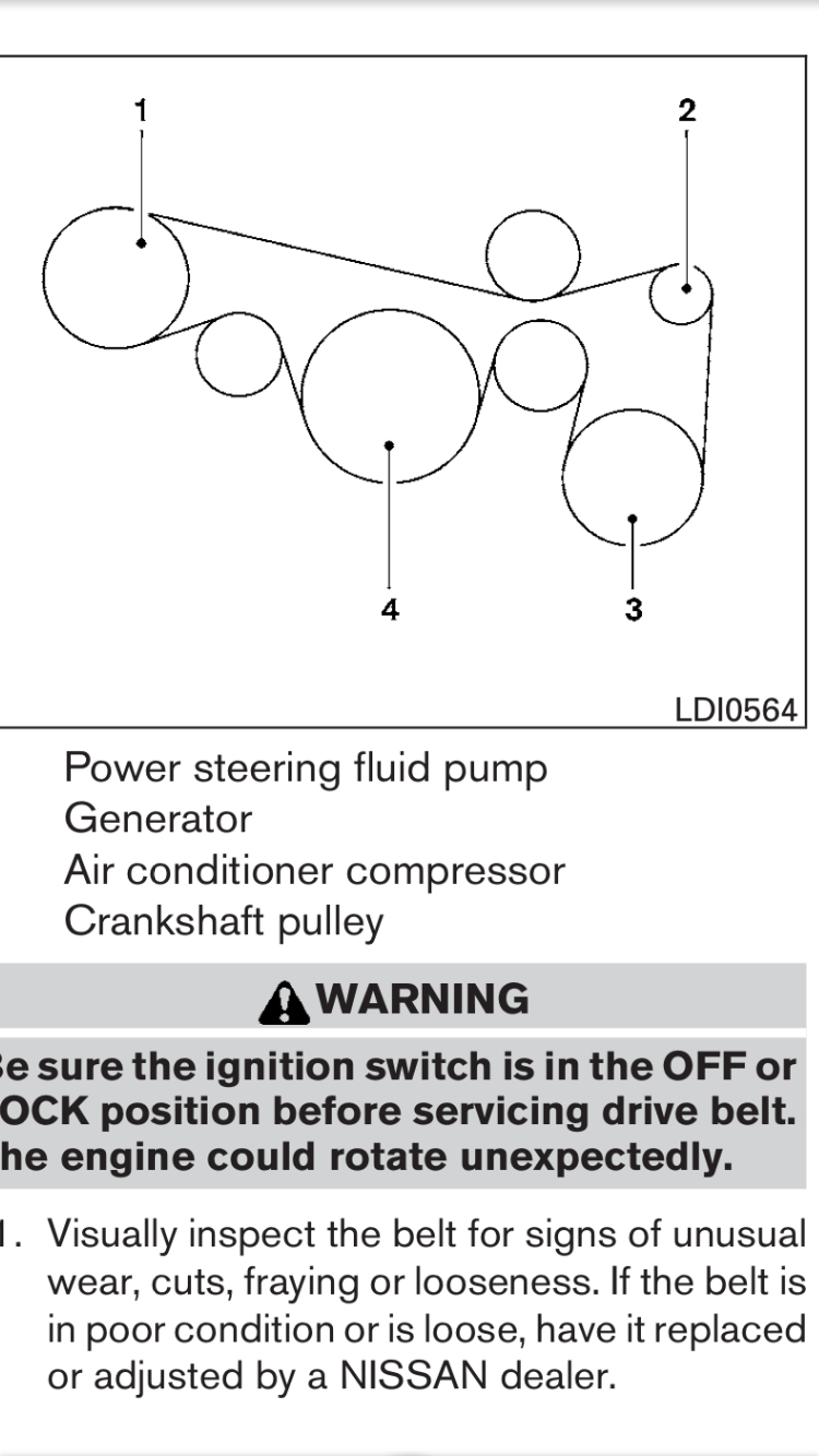

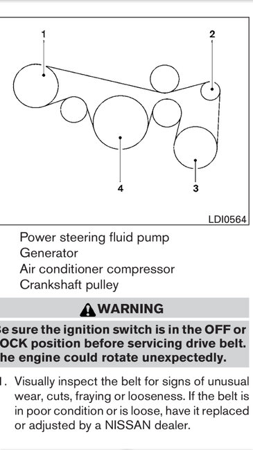

Hi, I was wondering if we could get a serpentine belt diagram please?

Sure, we hope this helps. Thanks for using 2CarPros.
Image (Click to make bigger)

Nice diagram KOOLCADDY6!
