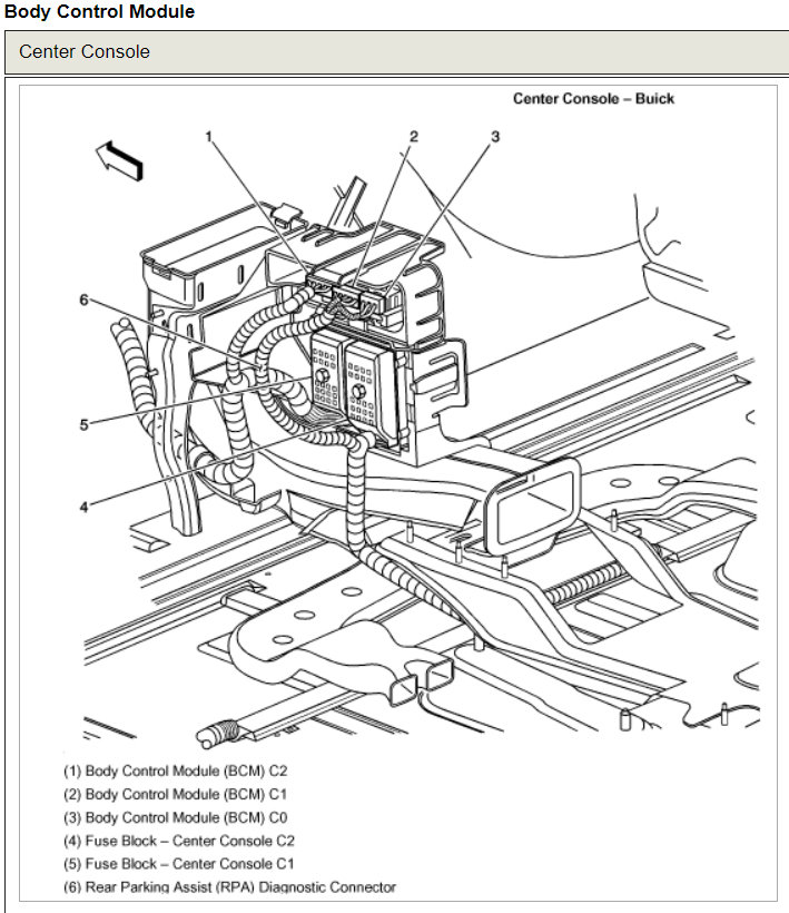

I got a 2004 Buick rendezvous it stopped on me wouldn't jump off when I got it home changed starter didn't help but left it unhooked from battery now found inside car 30 amp metal fuse bad do I need to reset bcm cause I now don't have low beam head lights window want work doors locks don't work so what cause that
Sunday, February 25th, 2018 AT 6:33 PM
KEN L
  • MASTER CERTIFIED MECHANIC
  • 55,266 POSTS
It sounds like the BCM has had a problem could be from a voltage spike when the battery was connected.
You will need the BCM reprogrammed by a shop here is the location.
Wednesday, February 28th, 2018 AT 11:23 AM
LUCKYONE
Thanks I got it fixed it was the wires got cought in the seat rail and cut them caused a direct short.
