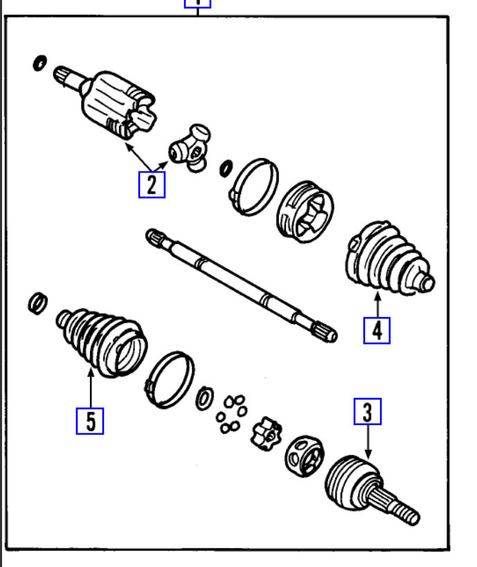

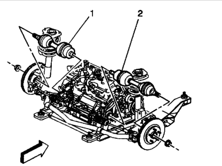

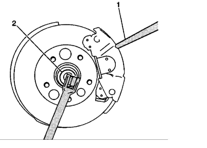

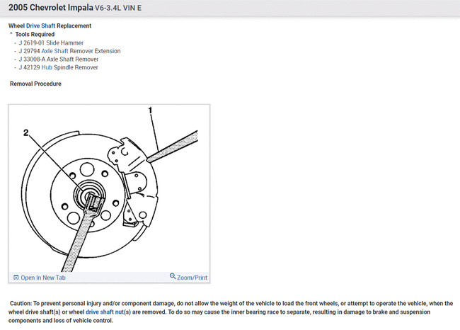

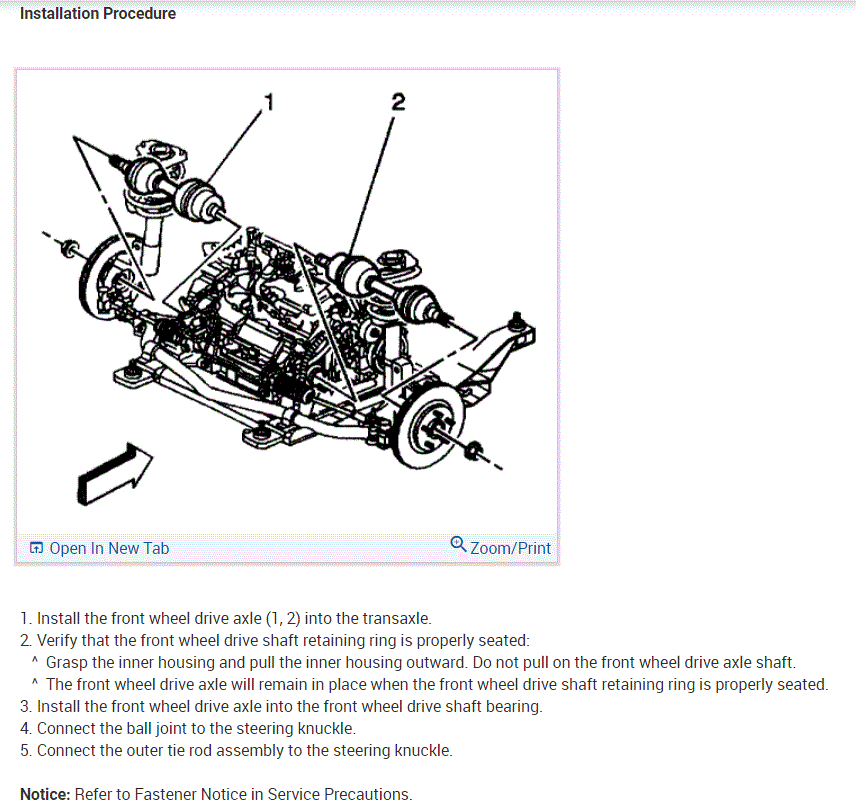

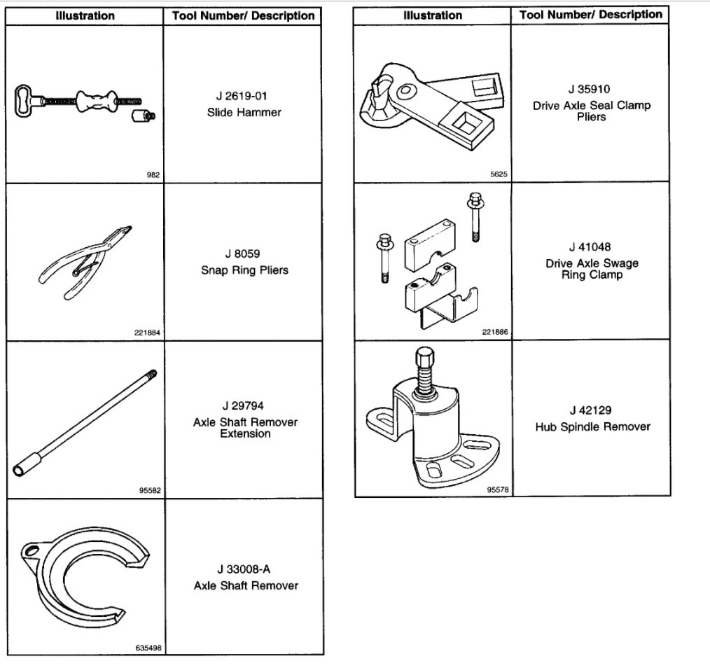

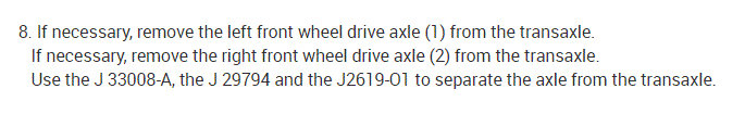

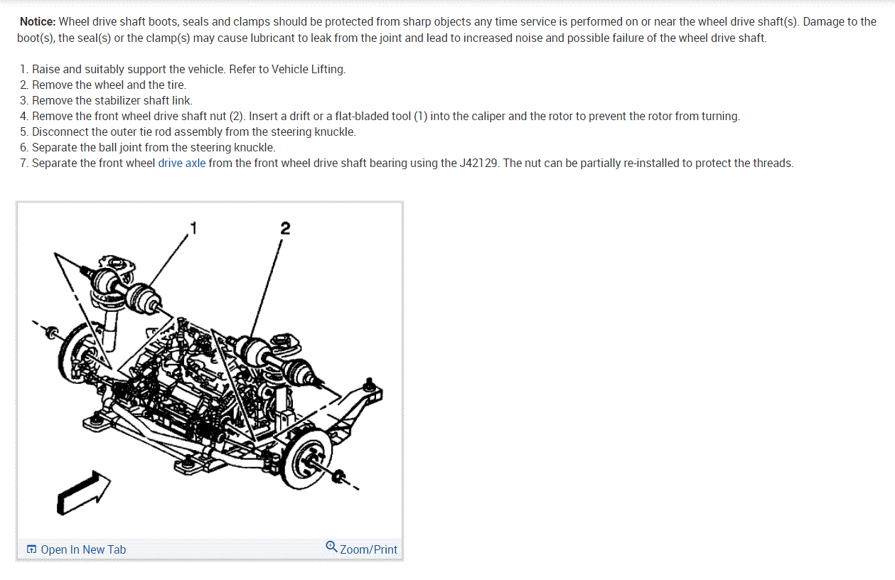

I have specific directions if you choose to do it yourself. Let me know., but if you look at the pics below, they include the directions and relevant pics specific to your vehicle for CV axle replacement.
Check out the diagrams (Below). Please let us know what you find. We are interested to see what it is.

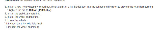

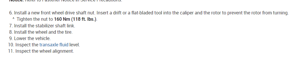

Here is the socket size is 30mm or 28mm they sometimes change with suspension packages. Here is some additional information along with a guide to help you get the job done.
Front Drive Shaft Nut 160 N.m (118 lb ft)
This guide should help
https://www.2carpros.com/articles/replace-cv-axle

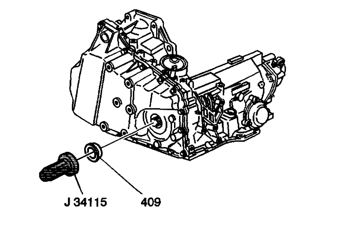

Okay, I attached the location of the seal for you. Make sure the axle is seated on the C clip. If it is not, it can move in and out and will leak fluid.

8. Use a flat bladed screwdriver or a suitable tool to remove the oil seal (409) from the transaxle side case (401).
Installation Procedure
1. Lubricate the seal lip with transaxle fluid.
Important: Carefully guide the axle shaft past the lip seal. Do NOT allow the shaft splines to contact any portion of the seal lip surface.
2. Install J 37292-B in the seal (409).
3. Use J 34115 to install the new seal.
4. Remove the J 37292-B.
5. Install the drive axle to the transaxle.
6. Install the left lower ball joint to the left steering knuckle.
7. Install the left tie rod end to the left steering knuckle.
8. Install the left stabilizer shaft link to the left lower control arm.
9. Install the left front tire and wheel.
10. Lower the vehicle.
Notice: Refer to Do Not Overfill the Transmission Notice in Service Precautions.
11. Adjust the fluid level.
12. Inspect for proper completion of the repairs.
13. Inspect for proper fluid level.
14. Inspect for fluid leaks.

You need to undo the bolt on the wheel first then amack the axle with a hammer to break it loose. Then take the wheel off, undo the nut that holds the ball joint on pop that loose, take a big screwdriver and pull the axle out all the way, replace the seal and reinstal everything.
