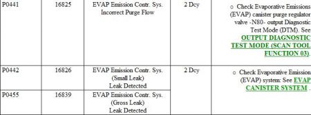

Here are the description of the 2 codes.
https://www.2carpros.com/forum/automotive_pictures/192750_P0441_16825_98A6_1.jpg
I believe you have access to the apppropriate scanner for testings.
The procedures for testing are rather complicated to be printed here so I will send them to your email. It is not complete and for any additional sections please let me know.

Code 16825 affects the fuel pump and relay operations.
The difficult starting after refuelling is most probaly due to the CEL affecting the operations of the fuel pump and relay circuits.
After refuelling, turn ignition on and listen if the fuel pump whirrs.
I am unable to find any TSB on the problem and diagnostics are vague. The test that I sent you would determine if there are any faults with any of the components that may cause the difficult starting.
