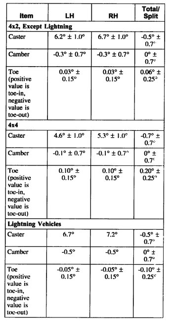

I need front end alignment specs.
Thursday, September 26th, 2019 AT 7:07 PM
3 Replies
BMDOUBLE
MECHANIC
1,139 POSTS
Here you go.
Image (Click to make bigger)
+1
Thursday, September 26th, 2019 AT 7:18 PM
KSAINE
MEMBER
2 POSTS
Thank you so much. I have been online for two evening's trying to find this information. Next time I have a mechanical question I be coming to you guys.
