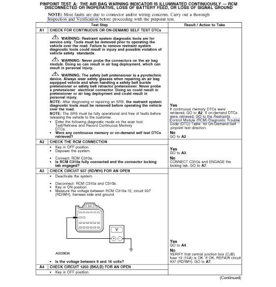

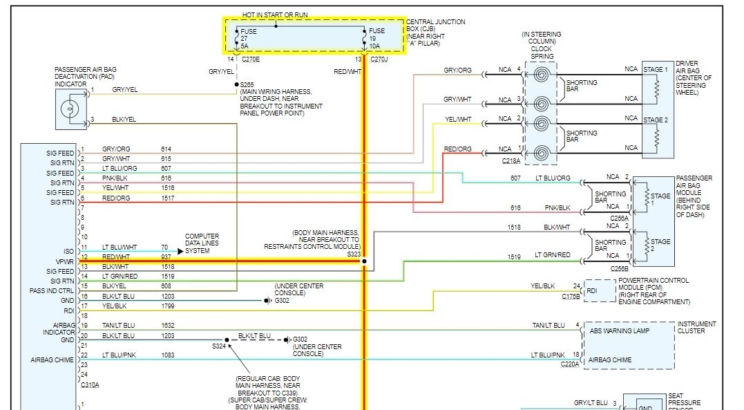

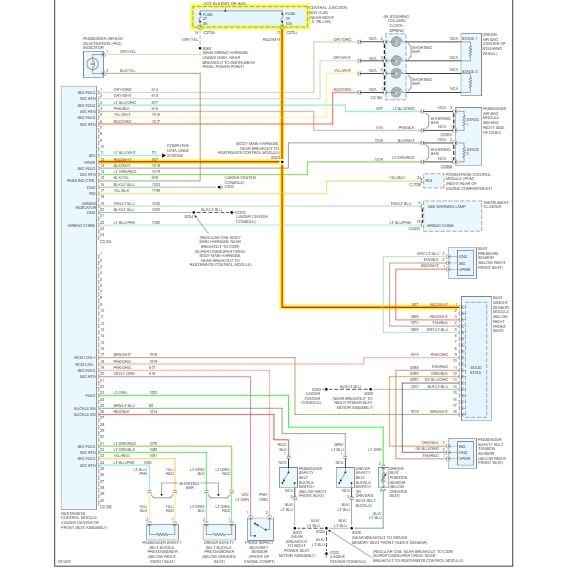

This code has to do with a power feed to the module for the airbag.

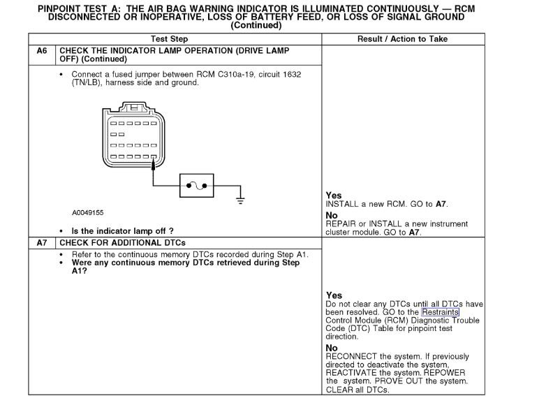

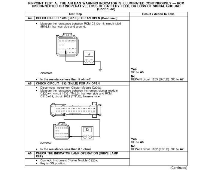

I attached a flow chart and description for the procedure to find the failure.

Possible Causes
An air bag indicator that is illuminated continuously can be caused by:
- fuse.
- damaged ignition circuit.
- RCM disconnected from the vehicle harness.
- a loss of RCM signal ground.
- a faulted RCM.
- damaged wiring, terminals or connectors.
- a loss of RCM ignition feed.
- a faulted instrument cluster module
