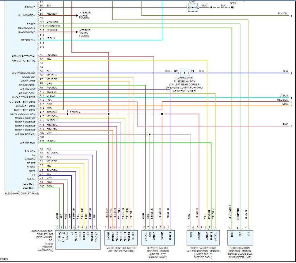

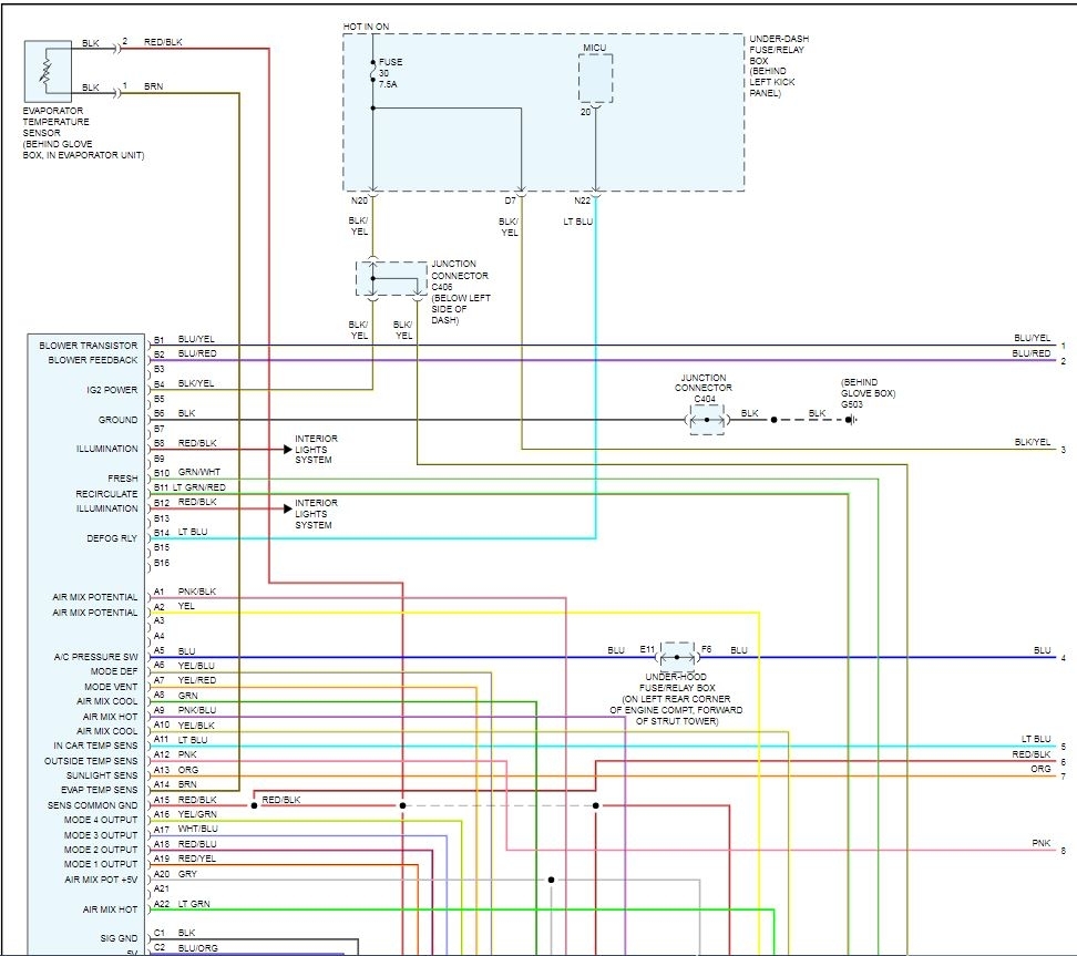

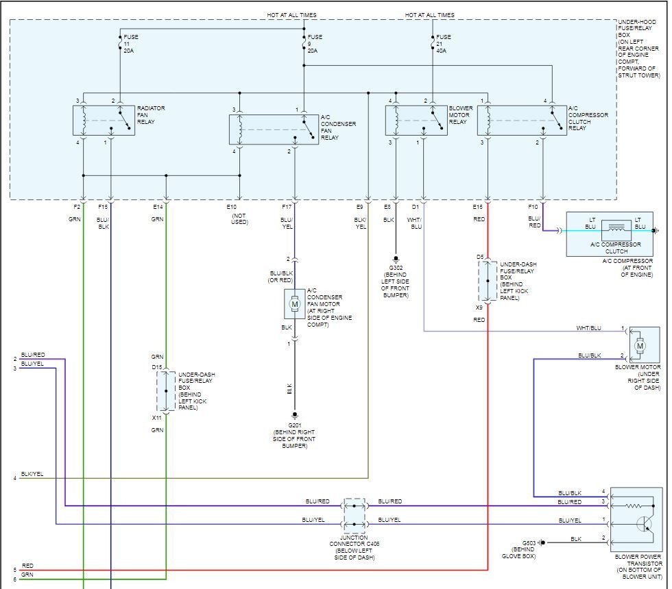

Hope the diagrams help.
Aug 21, 2008 at 9:47 AM
XAKEP
  • 8 POSTS
Thanks a lot for the diagram, but I cannot read it well. The image was probably resized by the web-site. Could you please upload it to some image/file sharing web-site that does not resize images or at least keeps a decent resolution. Alternatively, could you email it here please tigran_m@mail.ru.

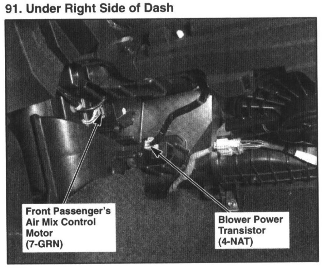

I am pretty sure that I got a failed blower transistor because when I connect the blue/black wire to the ground the blower motor runs. The blue/black wire is connected to the negative of the blower motor.
Please help to find where the speed control transistor is mounted.
Aug 21, 2008 at 7:52 PM
KHLOW2008
  • 41,814 POSTS
Hi xakep,
Under the right side of the dash
See the diagram below
Aug 22, 2008 at 7:56 AM
XAKEP
  • 8 POSTS
THANKS! I located the transistor. Trying to order it now...
