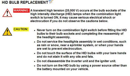

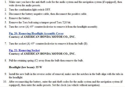

How do I replace the low beam bulb on my car. It is hidden inside a high voltage container.

Below are the instructions for replacing the HID Bulb.
FIGURE 20
FIGURE 21
Hope this helps.
