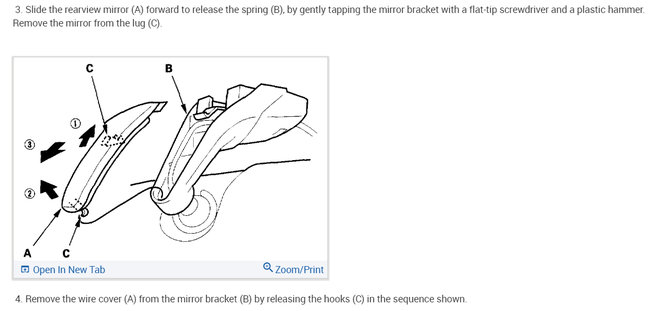

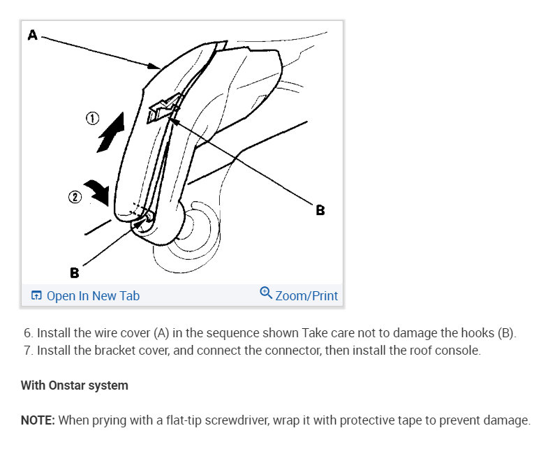

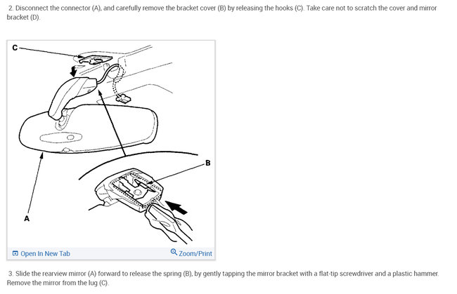

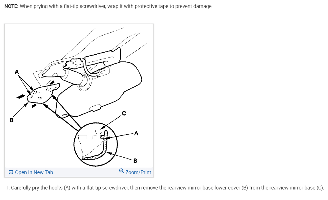

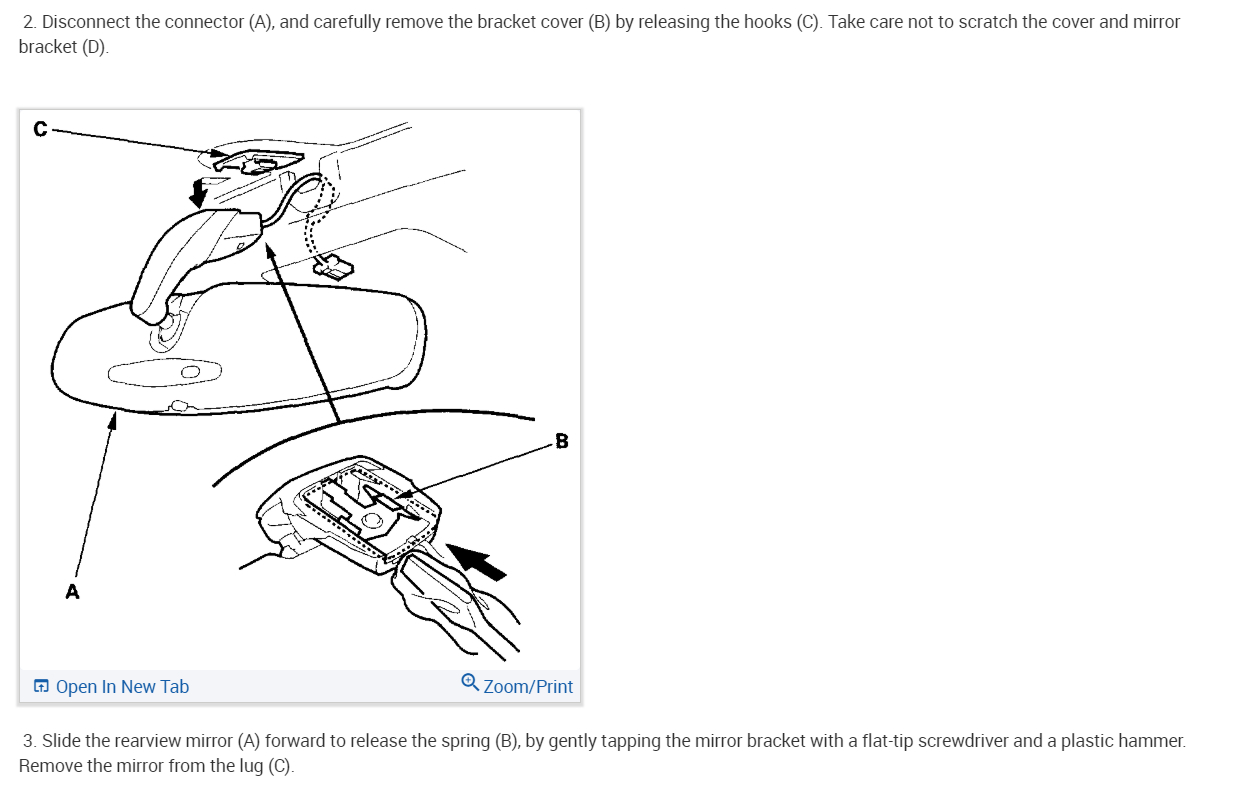

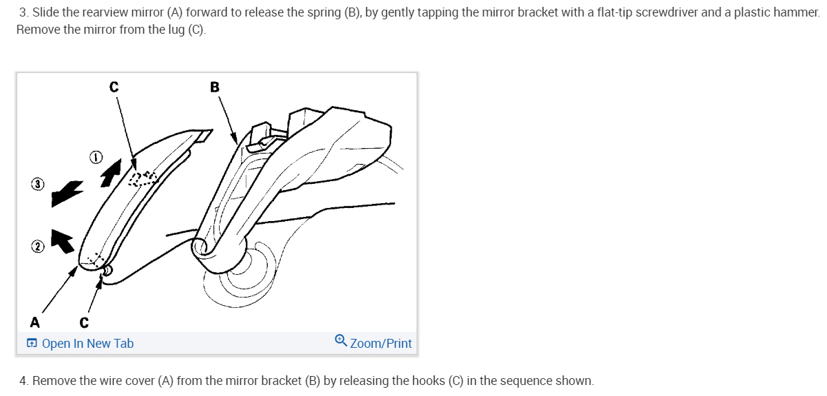

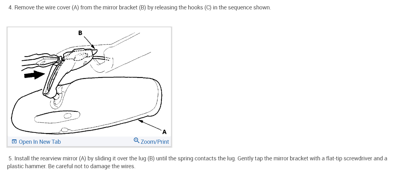

How do you remove the inside rear view mirror?
Monday, February 16th, 2009 AT 9:08 AM
3 Replies
DOCFIXIT
  • 18,828 POSTS

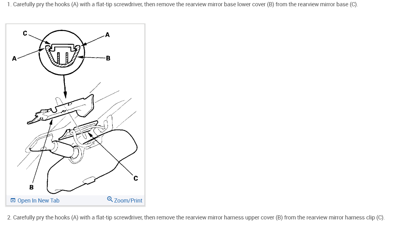

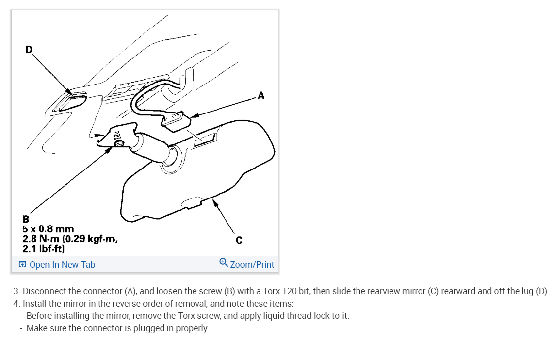

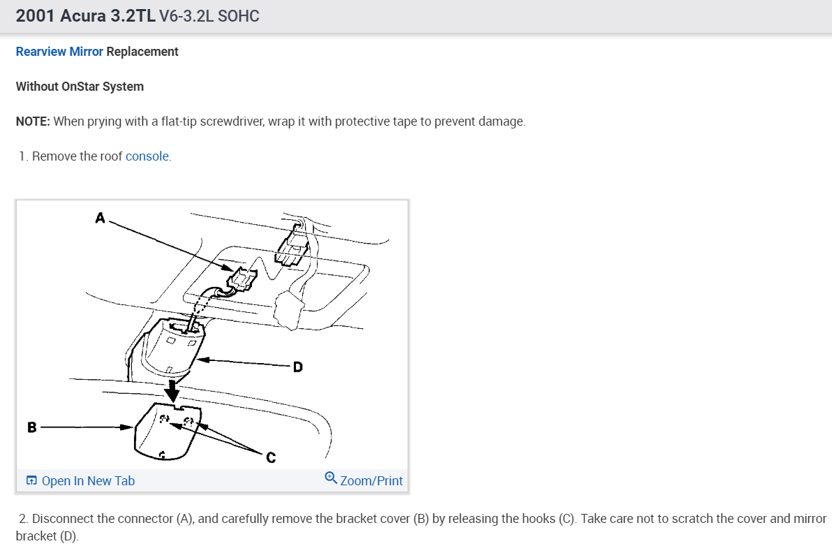

Here are the instructions and diagrams to help you remove the rear view mirror. Check out the diagrams (Below). Please let us know if you need anything else to get the problem fixed.
