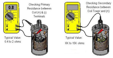

how can I test my ignition coil?
Saturday, December 26th, 2009 AT 10:55 PM
  • 75,992 POSTS
Check resistances on the primary winding of the coil positive and negative terminal, and for secondary resistances from the positive terminal of the coil to the center tower of the coil.
Primary readings: 0.4 to 2 ohms
Secondary readings: 6K to 15K ohms
