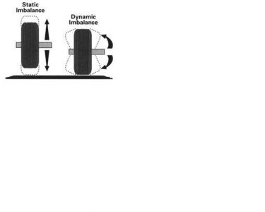

The original tire of my 05 MDX has balancing in two locations; on the inside edge of the rim and a strip on the internal surface of the rim close to the outer side of the vehicle, the purpose is to balance the tire from both sides. I had the tire balanced yesterday and the gentleman who did the job explained to me that the tire can be balanced without putting the strip (he called that a static balance) After the tires were balanced the reading on the COATS 1050 DIRECT DRIVE COMPUTER BALANCER shows 00 for one side and dashes for the other side. Is the tire really balanced in that case and if it is why the factory needed to add the strip? Thank you.

Not sure. Someone else might have input on this but one thought comes to mind. It might be possible that they balanced the rim without the tire and then put the tire on and rebalanced without getting rid of the first balance of the rim.

The tire and wheel assemblies should be balanced using a dynamic balance either on the car or
off the car.
The dynamic type produces a more accurately balanced tire and wheel assembly than does the
static type and is therefore recommended.
Once you have properly mounted and inflated a tire, you must balance the assembly. Balancing
your performance customers’ tires and wheels is another area where attention to service can pay
off. These customers are driving vehicles with steering and suspension systems that are so
sensitive that even the average driver can feel minor handling problems. Poorly balanced tires are
what will drive them to other tire dealerships.
Proper balancing is critical for optimal vehicle performance, especially at highway speeds. When
tire and wheel assembly are unbalanced, a vibration can result from wheel shimmy (shaking from
side to side) or wheel tramp (tire and wheel hopping up and down). Therefore, it is important that
these assemblies are in both static and dynamic balance.
Static balance exists when the weight mass is evenly distributed around its axis of rotation. Static
imbalance can be detected from vibrations through the seat, floor and steering column. These
heavy or light spots in the tire should be eliminated by placing wheel weights, equally distributed,
on both the inside and outside rim flanges.
Dynamic balance exists when the weight is equally distributed both around its circumference and
on either side of its centerline. Dynamic imbalance is the result of heavy or light spots on the side
or off-center of the wheel, tire tread or sidewall.
Note: A tire can be in static balance and still have dynamic imbalance.
The best way to ensure proper balance is to use an off-the-car computer-balancing machine.
Follow the machine’s operating instructions step by step. The balance will measure the
assembly’s fluctuations in weight by stimulating its operating on a vehicle. The balance will
indicate that correct amount of weight to use and where to place each weight.
