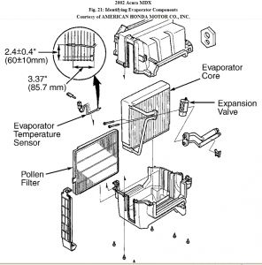

PLEASE TELL ME WHERE THE EXPANSION VALVE IS LOCATED ON MY ACURA MDX. THANK YOU

Expansion valve is part of the A/C evaporator inside the case where the cabin air filter is.

Bolts to evap lines.
