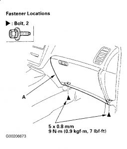

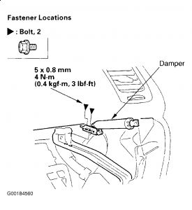

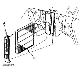

How is the cabin filter replaced on my 2002 Acura MDX

Follow diagrams
