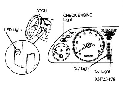

Transmission s3 light is flashing at all the time?
Monday, August 11th, 2008 AT 6:19 PM
3 Replies
KHLOW2008
  • 41,814 POSTS
Hi CVjuny,
An error has been detected and the Automatic Transmission Control Unit is sending a signal to the S3 light to let you know.
https://www.2carpros.com/forum/automotive_pictures/192750_IntegraATCU_1.jpg
With ignition switch on, count the number of blinks of LED lights in ATCU window and post here.

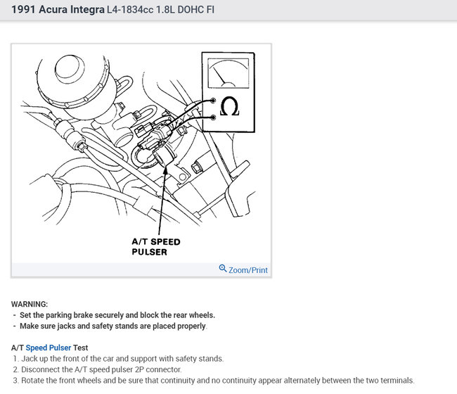

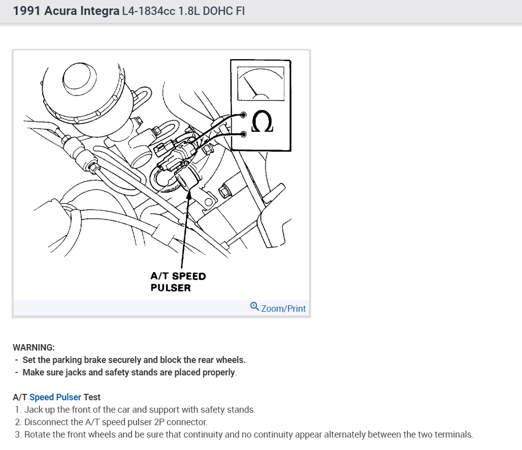

My blinkers light flashes two times and when I turn on the s3 my car does not turn on and when it does not blink s3 if it turns on?
Tuesday, August 7th, 2018 AT 12:52 PM
KEN L
  • MASTER CERTIFIED MECHANIC
  • 55,281 POSTS
It sounds like the transmission shaft speed sensor has gone out. Here is a video of how it is replaced and a diagrams below to show the location in your car:
https://youtu.be/f3bETtCIdxM
