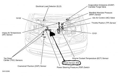

Where is the knock sensor located on a 2003 Acura CL?

Knock Sensor (KS)......On top of engine block, under intake manifold. See Fig. 1
