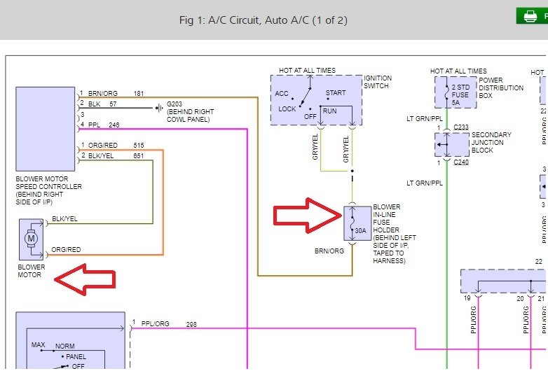

Where is the HVAC blower motor resistor with auto temperature control located at? Does not blow air.

I got you a partial diagram from "Prodemand" showing the blower motor.
Let me know if this helps.
