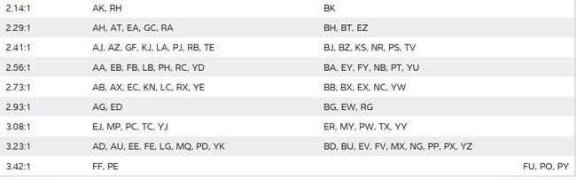

I am looking to purchase the car listed above it has a Pontiac 400 and a three speed transmission. I asked the owner if the car would make the drive as it seems to be in very good condition and he said that with it being a three speed and driving seven hundred miles with a three speed at eighty mph would be to high rpm's for that amount of driving. This did not make sense to me, what do you think?

It depends what rear end is in it if it has a 3:55 ratio or less you should get about 15 on the E-way, but if it has a 4:56 or something like that maybe about 8 and engine would spin about 5 grand at E-way. About 3500 otherwise.

Would driving at 65-70 mph be an issue? I am not sure what rear end is in it and neither does the owner. He said it is the stock transmission that came in it when he purchased it in 1980.

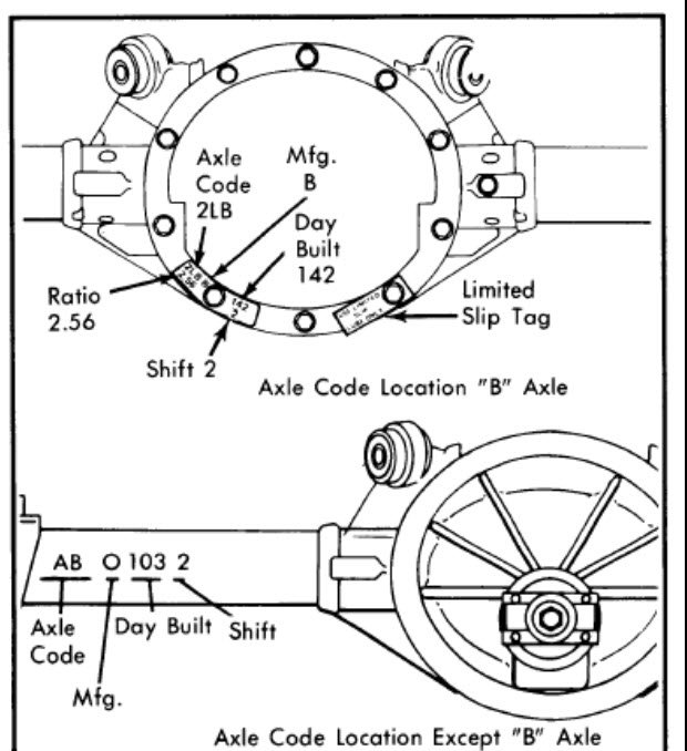

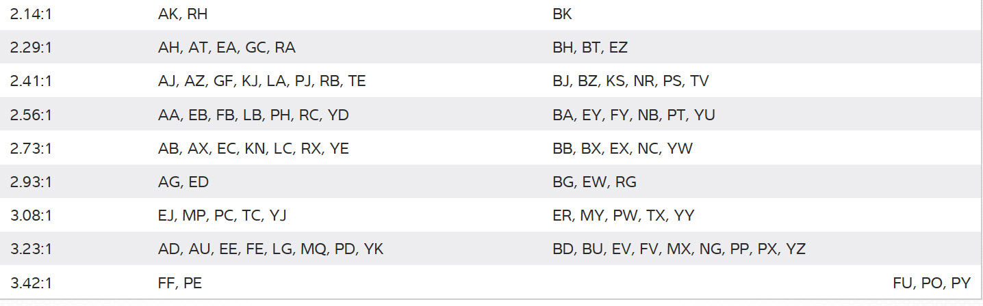

HMAC300
  • 48,601 POSTS
Go on E-way for a short distance at that speed see what rpm's you turn it should be okay. See pictures. If you still have tags on rear end and feel like crawling under it the pictures show you where to look and what axle ratio you have unless it has been replaced with a higher gear.
