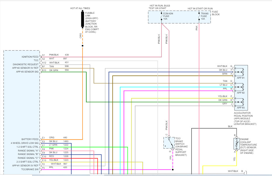

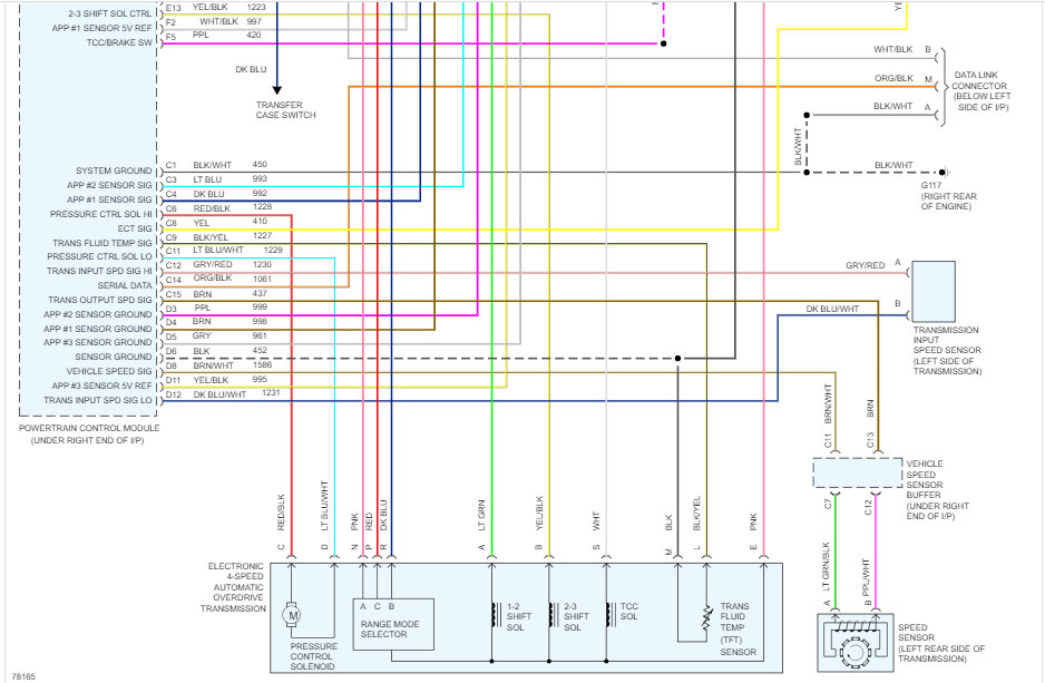

Been working on this pickup k2500, VIN 2GCFK29S1R1261336.

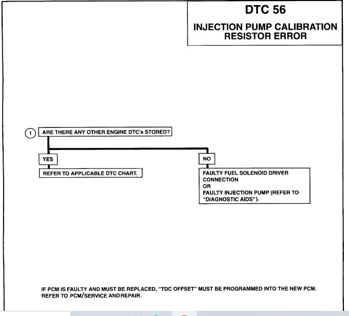

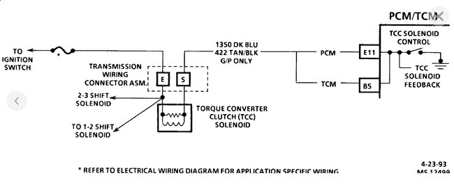

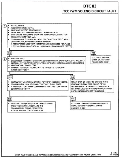

Transmission will only shift up to second gear. I have error codes 83 and 56.
Lot of electrical issues.
Have a 506 Diamond star Block and a 4l80e transmission.
Installed a used transmission connector on the harness but can't figure it out. All the diagrams i can find don't match with my harness. Can you help me please?
Jul 13, 2022 at 2:02 PM
  • 110,190 POSTS
I attached the wiring schematic below for the transmission circuits. It was only one page, but I had to cut it in half to make it readable for you. I did overlap them so you can follow from one to the next.

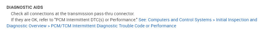

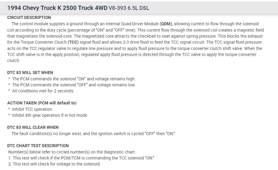

Code 83 is related to the torque converter clutch power solenoid. I attached the diagnostics for it after the schematics (pics 3-6).

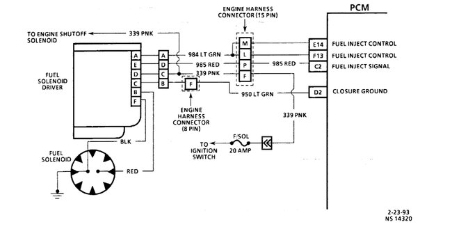

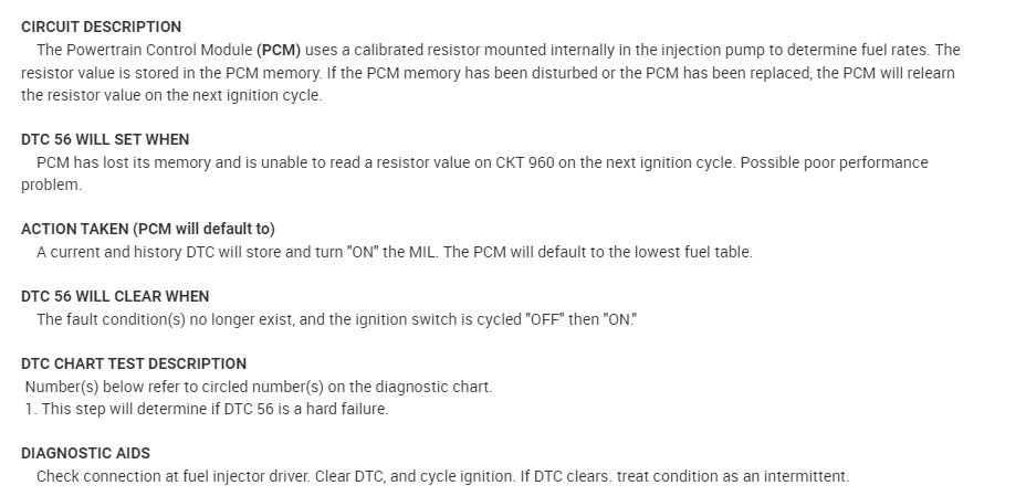

Code 56 is related to the fuel injection. The remaining pics are the diagnostics for that code.
