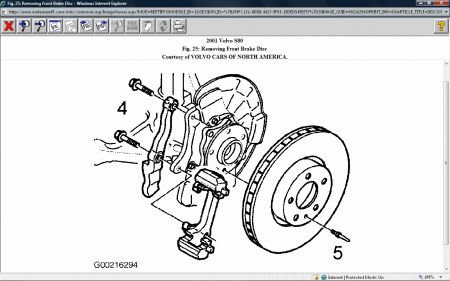

Have removed pads, caliper, retaining/alignment pin & rotor won't budge. It has to be simple - what am I missing?
Friday, June 20th, 2008 AT 5:48 PM
MERLIN2021
MECHANIC
17,250 POSTS
Once all that is removed, if it's stuck, use a good ball peen hammer, hit the rotor a few times and it will loosen up!
