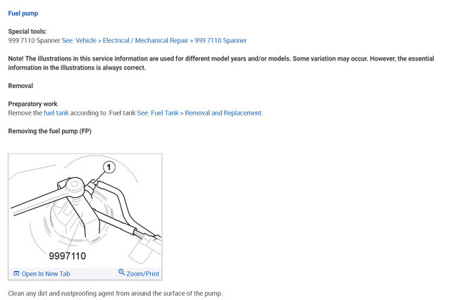

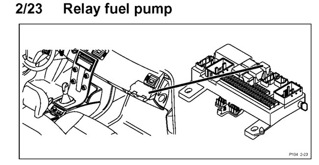

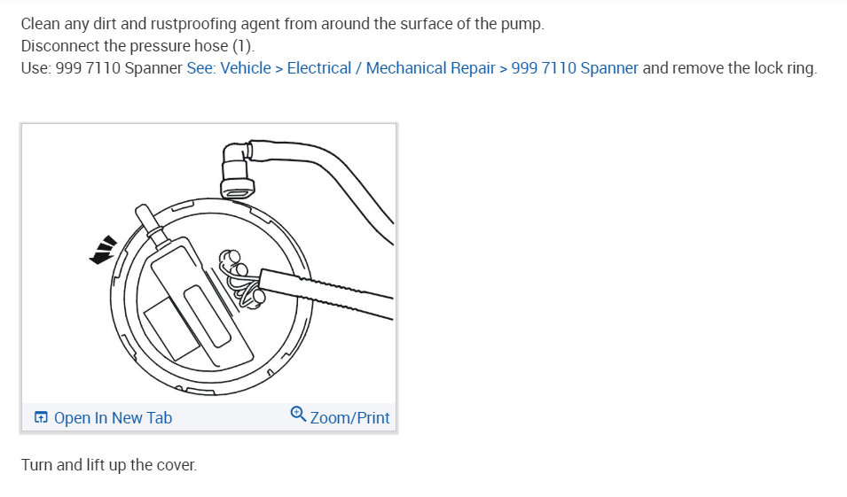

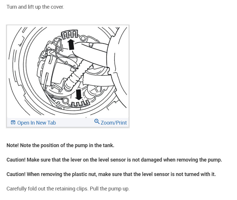

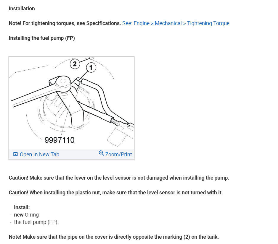

These problem can be difficult, having many of theses cars in the shop I can tell you the main wiring harnesses had problems, here are the fuel pump relay and fuel pump location with a guide to check for power.
Check out the diagrams (Below). Please let us know what you find.

the fuel pump is located in the fuel tank, on the top of it. you may have a access panel under the seat or in the trunk.

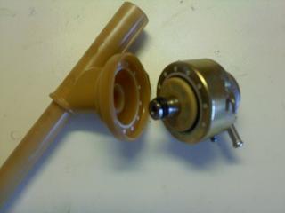

Two days ago on my way home my car stated losing power. The rpms would drop every time I would press on the gas pedal. I was able to limp it home by barely giving it any gas. Since then I have cleaned the throttle body, the IAC, the TPS, checked the FPR and replaced the fuel pump and fuel filter. Also checked the fuel pressure and it is at around 12 psi at the fuel rail and also right before the fuel filter coming right off the sending unit which seems rather low. Also took out and cleaned the spark plugs which were pretty black. After all that work the car will start but whenever I give it gas the rpms drop and it will not run steady at all. I pulled off the hose coming off the intercooler going into the throttle body and sprayed starting fluid into the intake and it wakes the motor right up. Also checked the plugs after just a few minutes of running the car and they have quite a bit of carbon build up on them after running it only a short amount of time. It seems like there is a fuel delivery problem but what else could be the cause??

Fuel pump is powered by fuse No20 15 Amp. Fuel pump relay is Fuel system relay in fuse & relay box. This is the only information given, Now if the relay is pulled and the pump is still active, check for power at the red wire, terminal 3 of the relay, if this is active there is a back feed of voltage from another source, which will require investigation hands on by an auto electrician, The fuel pump will stop if fuse No 20 is pulled. as there is nothing else down line to feed power to the pump. The diagram is rather complex so i will take a bit of time to look for a likely problem where a back feed may occur.

So after days of research and trying different things to fix the issue I narrowed it down to the fuel pressure regulator in the actual sending unit. What happened was the FPR metal housing had broke loose from the plastic housing on the return line. The fuel was bypassing the FPR and it caused the pressure to drop dramatically. In testing the part it completely broke away from the FPR housing and obviously needed to be replaced. After finding a used sending unit on ebay I replaced the part and the car started up and ran even better than before since it now had a new fuel filter, clean throttle body, IAC, and TPS. I hope this will help someone that might have the same problem as I did.
