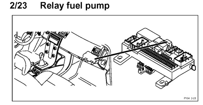

Sometimes the car would not start. Sometimes it will start normally and cut off without giving a warning after a few days. Or sometimes cut the supply time an again in one day. Where do I find the fuel relay plug in the car

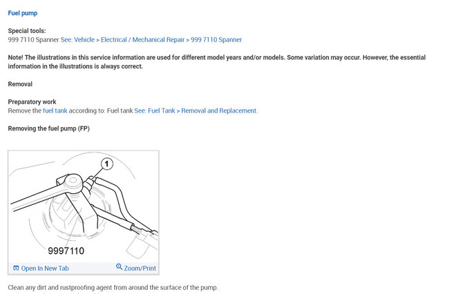

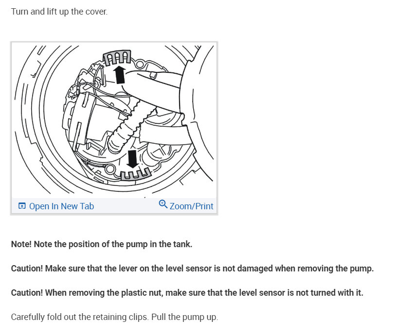

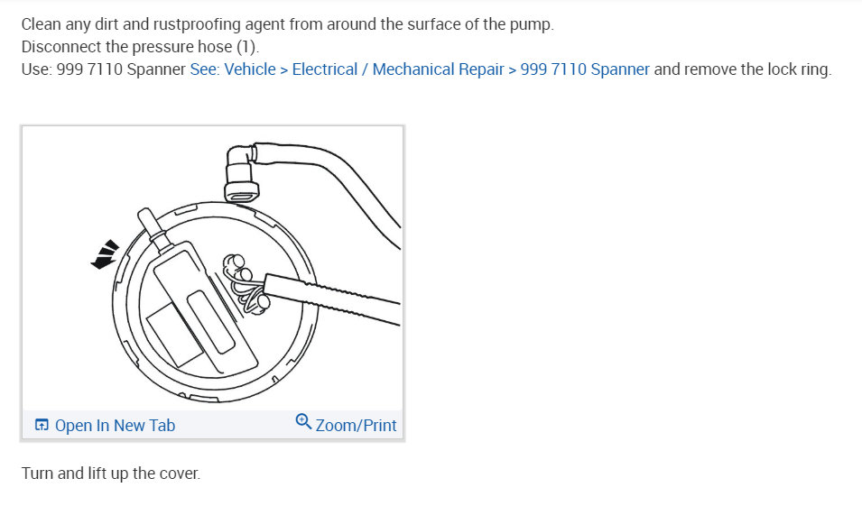

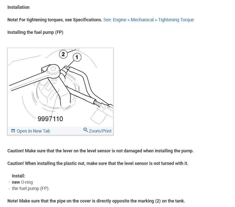

These problem can be difficult, having many of theses cars in the shop I can tell you the main wiring harnesses had problems, here are the fuel pump relay and fuel pump location with a guide to check for power.
Check out the diagrams (Below). Please let us know what you find.
Saturday, May 16th, 2015 AT 1:35 PM

The fuel pump is located in the fuel tank, on the top of it. You may have a access panel under the seat or in the trunk.
