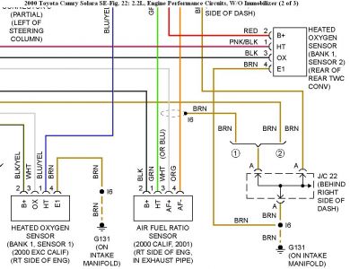

Where can I get a picture of an o2 sensor wiring harness?

Hi autokings2009,
Here is a schematic diagram of the O2 sensors.
