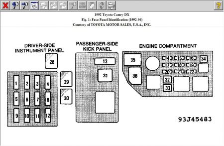

Where is the fuse for the radio and overhead lights located on 1992 Toyota Camry?
Sunday, November 11th, 2007 AT 4:02 PM
MECHANIC
75,992 POSTS
Its on no. 18 20amp fuse see below it controls the sounds system and overhead lights
