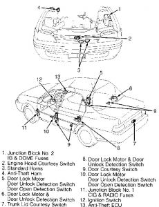

Well here we have (Courtesy of Mitchel) and Paul, the location of the security and Keyless entry components:
https://images.2carpros.com/forum/automotive_pictures/576_30961_toy_1_1.jpg
let me know if that matches with your vehicle..

Thanks, fisherman. The diagram is close but the security ECU is under the driver's seat. Turns out my wife had it installed when she bought the care so it is a Toyota system, but I guess you could call it aftermarket??
I spent several hours today trouble shooting things. My previous statement was incorrect. The alarm system DOES work properly. I just don't, sometimes :oops:. All lighting, radio, turn signals, etc. work. I pulled the distributor cap and rotor and ohmed out the coil and it is OK. That leaves things I probably can't test so may have to tow it to the shop. I really feel stupid since this all happened after replacing belts!
