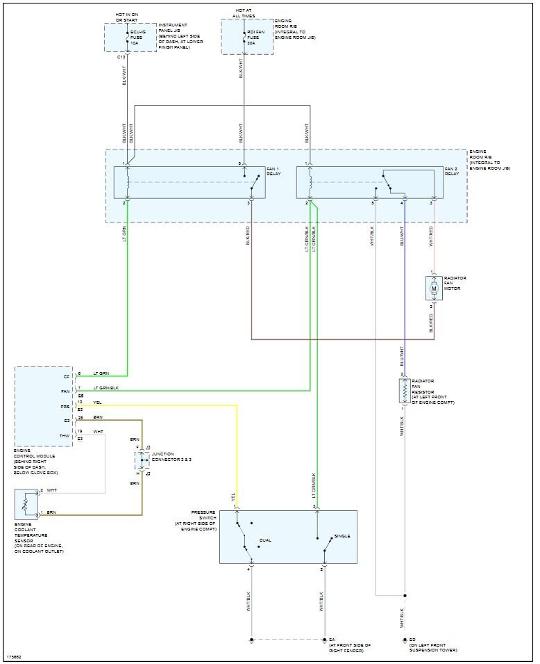

  • CAR REPAIR CONTRIBUTOR

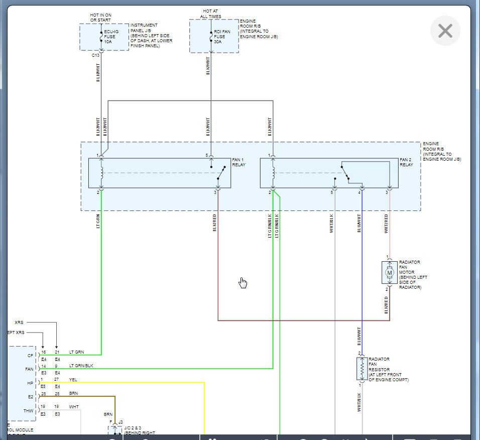

Okay. Let's focus on why you don't have power on that relay. Also, which terminal do you not have power on? Take a look at the wiring diagram and let me know what you find on each terminal when the engine is running. You should have 12 volts on terminal 1 and then the PCM and pressure switch will close which will ground the relay and that is what turns the fan on. So we need to find out if we have 12 volts on terminal 1 and go from there.

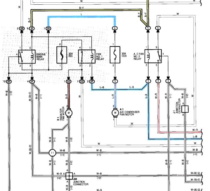

I have already replaced both radiator fan relays and this did not fix problem. When the A/C is turned on and dial set to coolest position this sometimes causes fan to come on, but not every time - result is engine runs very hot and/or in overheat position. Not sure what to do next. The fan runs, but not always. I thought relays were logical place to start, but they did not solve problem. What is next logical step? I want to fix problem but not keeping throwing parts at it. Since problem is intermittent it seems like it will be tricky to troubleshoot. Please help!

Hi Nick,
Thanks for visiting us. As to your problem. It be one or more of a few things. First thing as you stated that this was intermittent, I would start looking for loose or damaged wires, damaged connectors too.
Check the wiring between the fan fuse (30A) and the fan relay 1.
Then check the wiring of between the fan relays and the ECM.
The next thing I would check is the Engine Coolant Temperature Sensor.

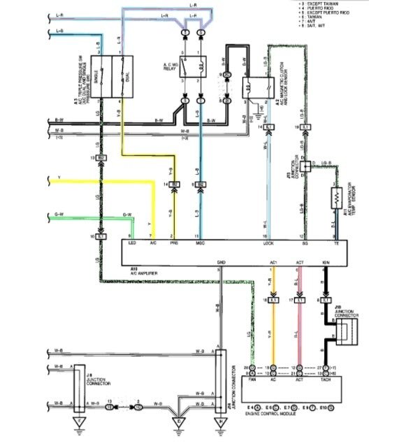

Here is a schematic of the system layout.
See picture attached.
Jon
  • 54,350 POSTS
When the AC is on please check the fan motors for power. This will tell you if the motor is bad. Here is the wiring diagrams so you can see how it works and a guide to help you check for power:
There is an AC pressure switch that controls the fan motors as well (P2).

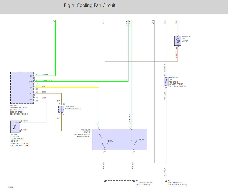

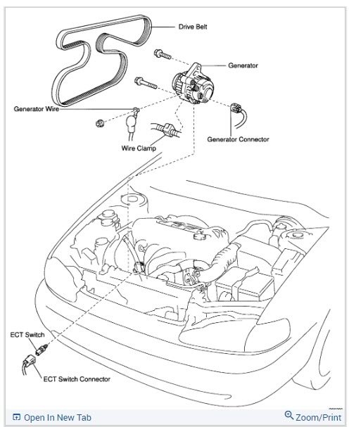

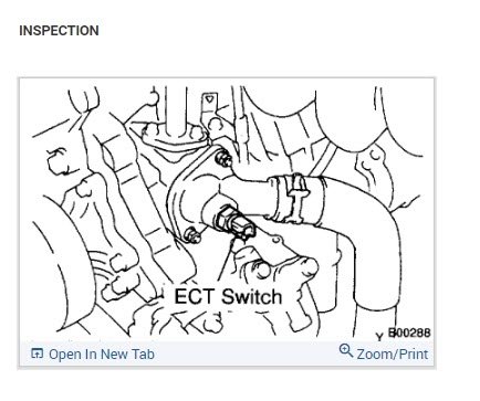

Hello, the vehicle's radiator fan stop functioning, it only comes on when the vehicle A/C is put on. I searched for temperature switch, I didn't see anyone. I try to jump the temperature sensor wires but it had three wires, I just know of two wires so I ran.
What could be the cause? And could I get the circuit diagram?
Oct 25, 2020 at 11:37 AM (Merged)

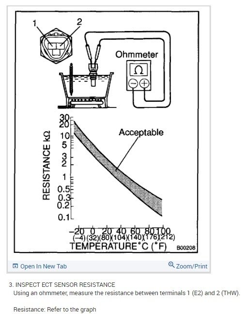

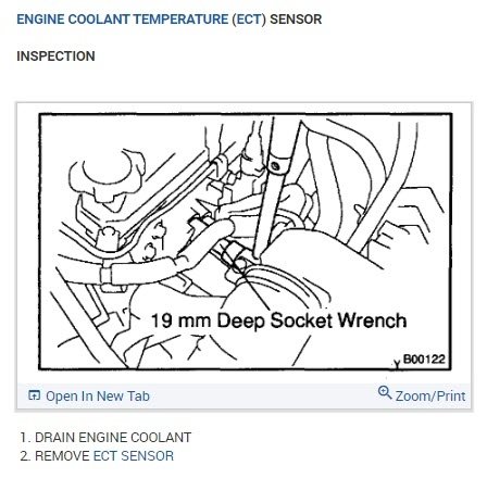

BMDOUBLE
  • 1,139 POSTS

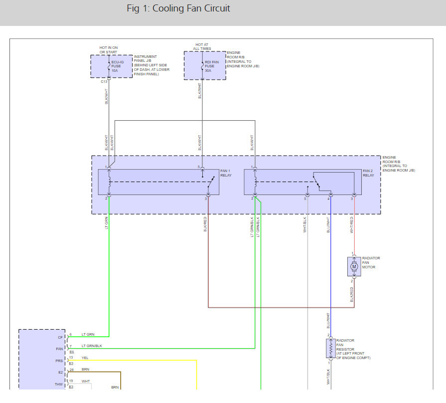

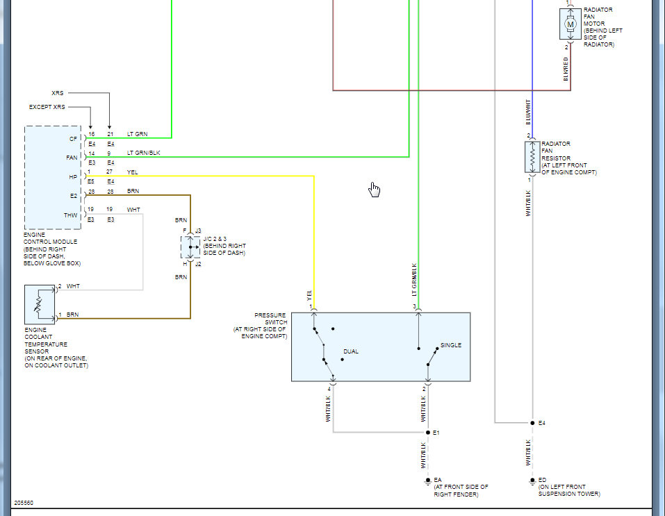

I've attached the location and the test for the coolant temperature sensor/switch, also the diagrams. More than likely you have an ECT sensor issue, but the tests should be performed to verify this.

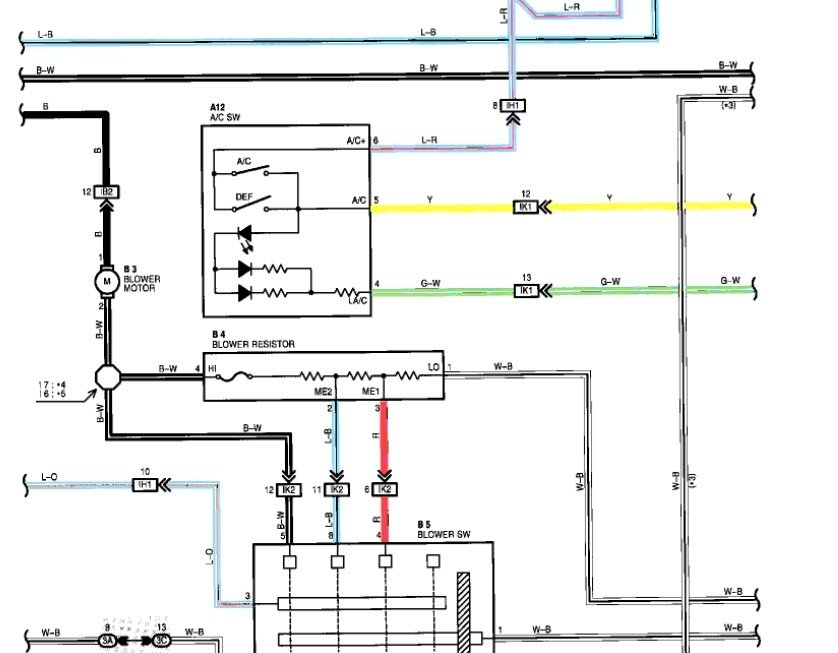

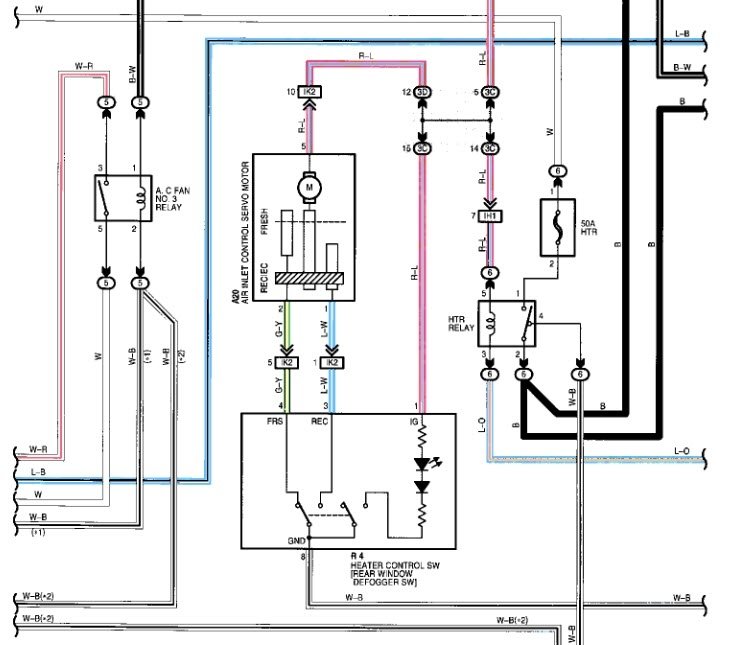

BLESSING EWOBOR
  • 753 POSTS
Thank you, but could you help me resend picture 3 and 4? it is somehow blur.

The one you sent on the diagram has two terminals and can I jumped the wires to check if the fan would comes on?
BMDOUBLE
  • 1,139 POSTS
Shorting those two together will not give you the desired effect, just by disconnecting the sensor the fan should go to full speed because the resistance will be high, so high resistance will be interpreted as high heat to the ECM, thus giving a desired high fan speed. Either a fuse is blown, and or the fan is drawing too many amps.
