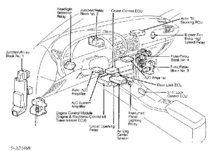

Where is the cruise control module/fuse located at on a 93 toyota celica gts 2.2L?

Your cruise control ECU is located behind center of dash, below radio (pictured below)..
Your cruise control fuse is fuse #3, a 15Amp fuse, located in the passenger side interior fuse panel.
