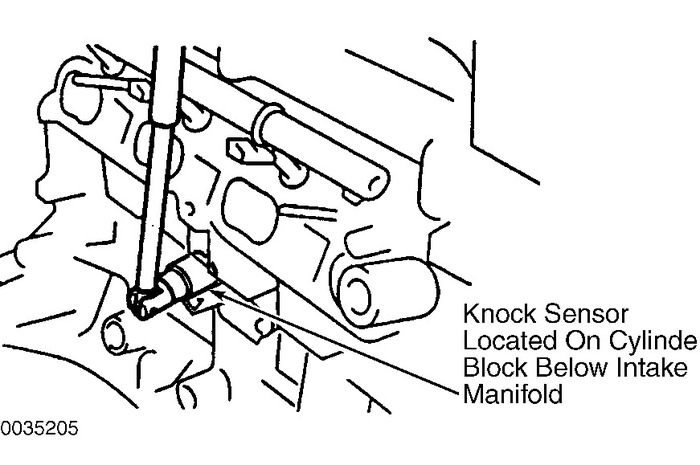

I just ran a OBDII scan on my car. It is the LE model four cylinder 2.4 liter engine, automatic transmission in which it gave me a P0325 code. I know this has to do with the knock sensor. My question is, where is it located on this vehicle and what do I have to do to get to it in order to replace it?
Aug 20, 2012 at 7:55 PM
HMAC300
  • CAR REPAIR CONTRIBUTOR
  • 48,601 POSTS
Note: Knock sensor may also be referred to as knock sensor No. 1.
Removal and Installation (Camry)
1. Knock sensor is located on side of cylinder block, just below intake manifold. See Fig. 10.
2. Service information is not available from manufacturer. It may be necessary to remove engine with trans- axle to gain access for removal of intake manifold. For engine removal, see appropriate article in engines.
3. It may be necessary to remove intake manifold for access to knock sensor. Use Oil Pressure Switch Socket (SST 09816 30010), or equivalent, when servicing knock sensor.
4. Tighten knock sensor and intake manifold bolts/nuts (if removed) to specification. See Torque specifications.
Fig. 10: Locating Knock Sensor (Camry and Highlander)

So, I will not have to take off the intake manifold to get to it then, right?

Reread item 3.

If you have the correct tool then you do not need to remove the manifold.

A 24 mm long socket with thin sides. From underneath vehicle check if you have space for an open end wrench.
Definitely you need not remove the engine.

Okay! I was thinking I would have to get to it from on top after reading a couple of replies from above. It got me confused! It looks like the easiest way is getting to it from underneath in which all I will have to do then is unplug and unscrew it. Is this correct?
Aug 21, 2012 at 2:16 PM
KHLOW2008
  • 41,814 POSTS
Yes, from underneath is an easier option.
Aug 21, 2012 at 2:20 PM
MADDOG77
  • 8 POSTS
I just want to clarify, on a four cylinder engine, the knock sensor is located on the backside of the engine block, directly below the cylinder head (facing the rear of the engine compartment).
1. Disconnect the cable from the negative terminal on the battery.
2. Pinch off the coolant hoses to the throttle body before removing the intake manifold/throttle body).
3. Remove the intake manifold.
4. Disconnect the electrical connector and remove the knock sensor.
5. If you are going to reuse the old sensor, coat the threads with thread sealant. New sensors are pre-coated already. Do not apply any additional sealant or the operation of the sensor may be affected.
6. Install the knock sensor and tighten it securely (approx. 30 ft-lbs). Do not over-tighten the sensor or damage may occur. Plug in the electrical connector, refill the cooling system and check for leaks.

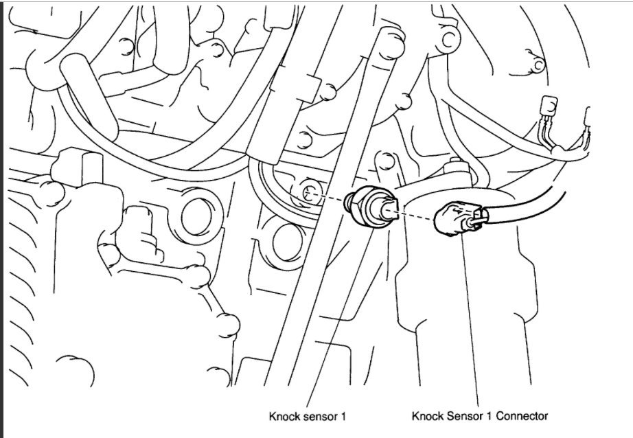

UDOG
  • 5 POSTS
The check engine light has come on and the code showing is PO325 (knock sensor - bank 1). My Haynes manual has a very non-specific drawing as to the location of the sensor. Do you have a link to a good picture of the location or step-by-step instructions on accessing it? Good diagrams of the engine space could be very helpful.
  • 54,354 POSTS
It looks like it is under the intake manifold. Here is a diagram of the location (below)
You will need to jack the car up to get to it.
