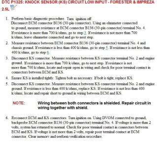

Could you please explain this trouble code and possible cause. P1325 I also have code 0141 02 heater circut bank 1 sensor 2

DTC P0141 simply indicates a faulty oxygen sensor that is located on bank 1, it will be oxygen sensor #2. details on the DTC p1325 are below..
