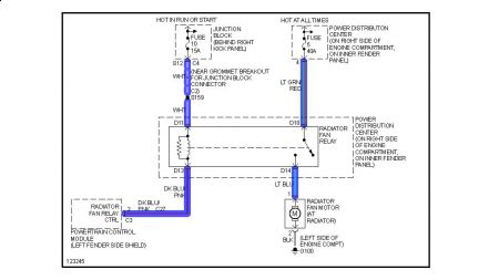

My 2001 Grand Cherokee recently ran hot, so after some investigation found that the fan is not kicking on to cool the engine. The fan and fan motor work (found this out by running power directly from that to the battery). But, when it has no 'help', it will not kick on on its own. The fan/fan motor is aparantly not getting power. So, how do I find out where the loss of power is? Thanks, Anita
Saturday, August 1st, 2020 AT 12:50 PM (Merged)
  • 75,992 POSTS
Next step is to check and test the radiator fan relay, also the engine temperature gauge switch or the coolant temperature sensor, fuse no. 10 15amp and fuse 5 40amp if all are okay-check the computer fan relay control circuit
See below
https://www.2carpros.com/forum/automotive_pictures/12900_fan_relay_15.jpg
Good Luck
ANITAINFL
Thanks to your advice- and the advice from local parts store- it WAS in fact the radiator fan relay. After MUCH searching and dis-assembly we managed to find the relay mounted under the passenger side headlight housing. Needless to say, this has been relocated. Thanks for the great, timely, advice! -Anita-in-FL
