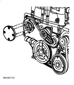

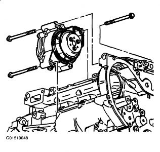

Where is the water pump on a 2003 pontiac grand am 2.2 liter?
Wednesday, November 11th, 2009 AT 12:25 PM
DOCFIXIT
MECHANIC
18,828 POSTS
On front left side engine but behind cover. Requires removal of exhaust, tire fender liner. And needs special tool. see diagrams
