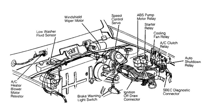

DESCHUTES606
  • 1991 PLYMOUTH ACCLAIM
  • 4 CYL
  • FWD
  • 116 MILES
I was hoping someone could help me out with my 1991 Plymouth Acclaim will not start. I turn the key over and it makes no noise but the check engine and oil lights come on. The windshield wipers still come on but the car does not start. Please help me! Thanks for your time.
Friday, July 24th, 2020 AT 6:20 PM (Merged)
  • 75,992 POSTS
Hi deschutes606, Welcome to 2carpros and TY for the donation
Start by making sure the battery condition and connections are good.
If okay check and test the orange fusible link at rear of battery,starter relay and ignition switch. See Starting system EWD below
https://www.2carpros.com/forum/automotive_pictures/12900_s1_42.jpg
https://www.2carpros.com/forum/automotive_pictures/12900_s2_39.jpg
