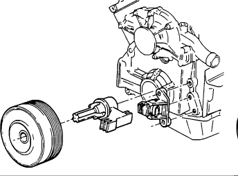

Car runs and starts good, but shuts off after fifteen to twenty minutes of driving. It then starts and runs in park. But shuts off when it is put in gear. Leave it set and cool off and it will run again for another fifteen to twenty minutes. Runs good, lots of power on street or highway until it shuts off. Then it sounds like a trains running over you.

This type of issue can be the result of several different things. However, most times it is related to the fuel system or ignition system. If you had it in my shop, the first thing I would check would be the crankshaft position sensor. Take a look at this link.
After you read from the above link, I feel you will understand why I suspect that part. This sounds like a typical heat related issue causing the sensor to fail.
With that in mind, I need you to check if there is a trouble code stored in the computer. It is easy to do. However, we could get a false positive. Read through this link. It discusses how to get the codes from the computer. A simple paper clip will do the job.

If you find a code, let me know what it is. If it is the crankshaft position sensor, I attached a picture of it so you can easily locate it on the engine. Try going over this guide as well
