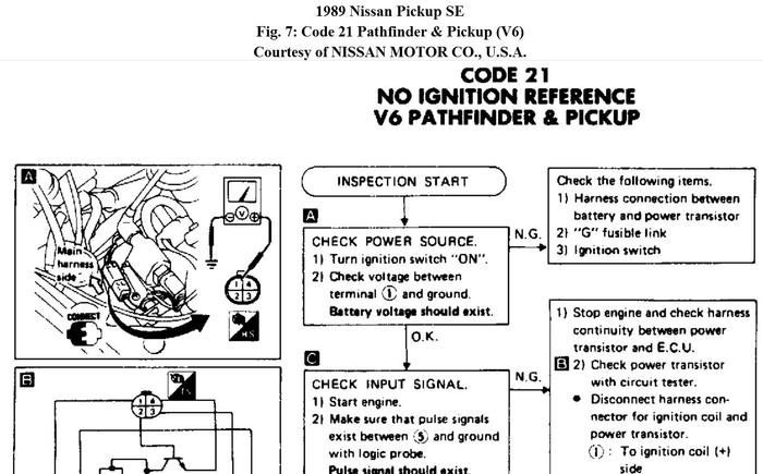

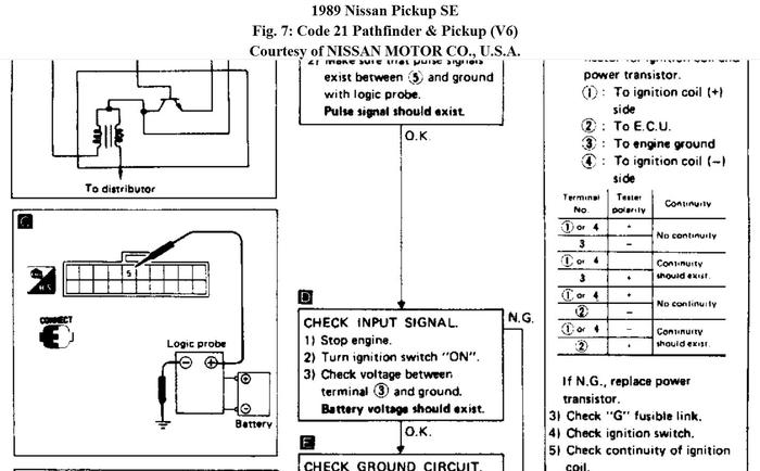

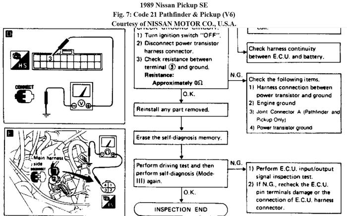

I have no spark. I have replaced the coil and the crank angle sensor, the ECU gives a code 21 the book says it's the ignition signal, I need to know what what would cause that and how can I fix it.
Monday, December 31st, 2012 AT 8:40 PM
9 Replies
KHLOW2008
  • 41,814 POSTS
check this guide out of checking and fixing a no spark issue. Refer to chart for diagnostic procedures as well.
Check out the diagrams (Below). Please let us know what you find.
