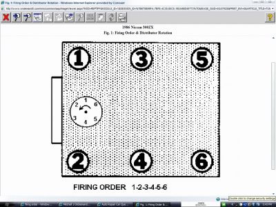

1986 nissan 280zx not turbo just needed the firing order and location of wires on cap please

Here ya go!
