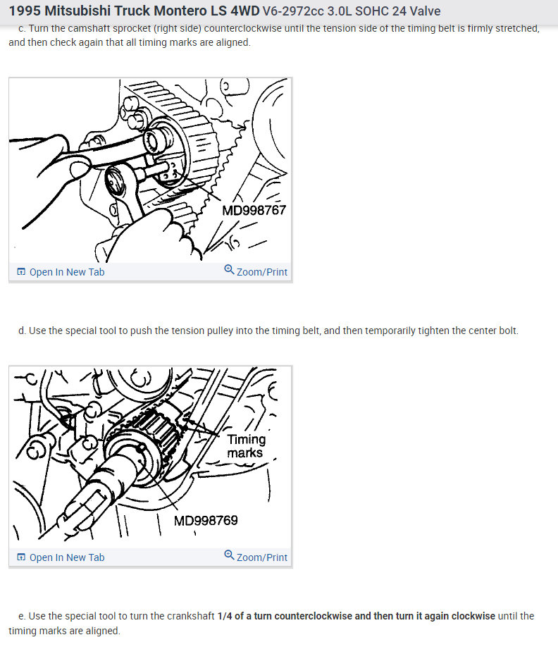

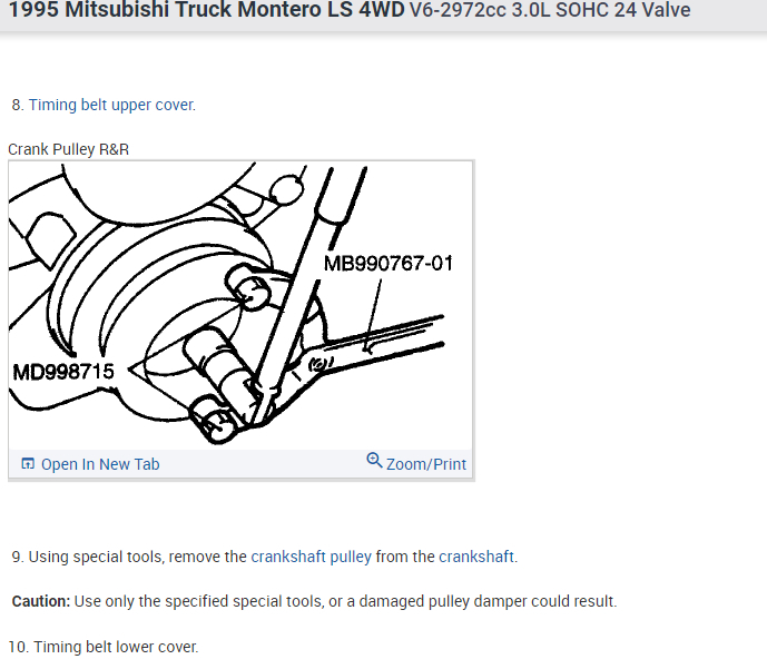

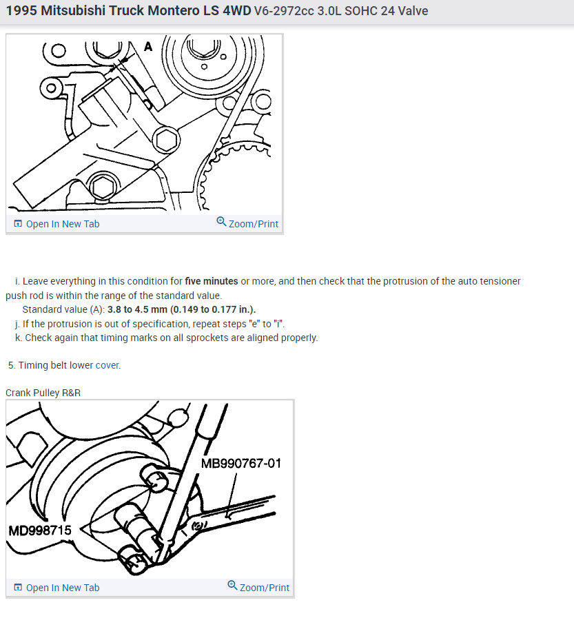

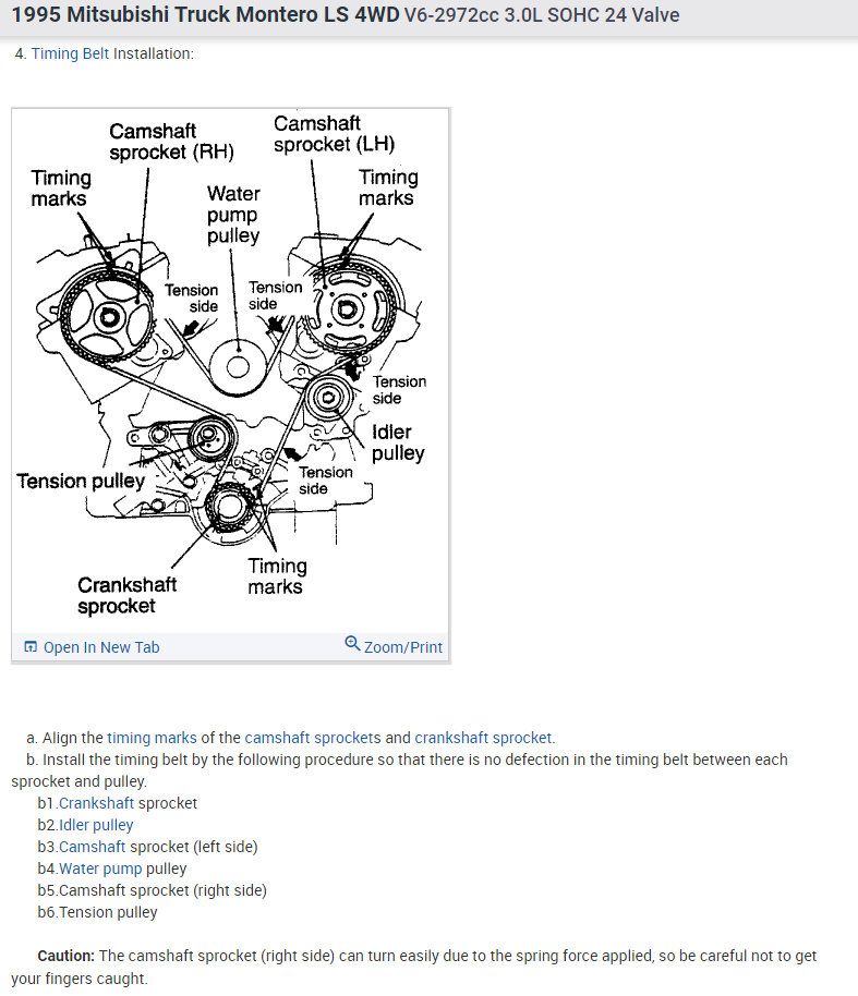

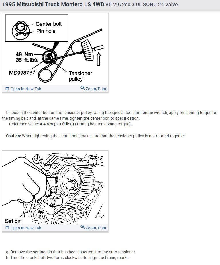

i did manually turned the crankshaft pass the hard point, now my question is, how do i know if i bent a valve? I have a 3.0 engine how do i know if i have an interference engine? i did some research on internet and it seems like i do have an interference engine. (the hard point still feels like the first time i turned it over)
please help.
Apr 30, 2008 at 5:30 PM
SQM
  • CAR REPAIR CONTRIBUTOR
  • 6,383 POSTS

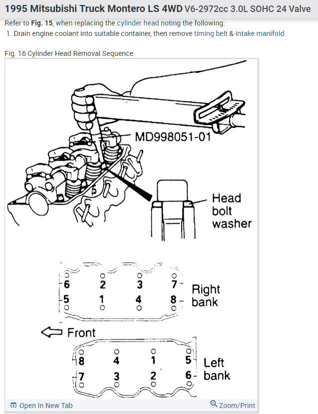

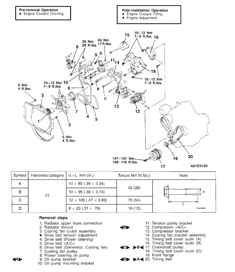

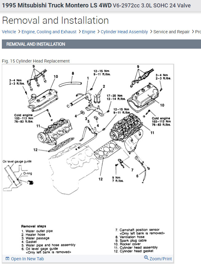

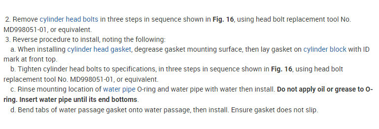

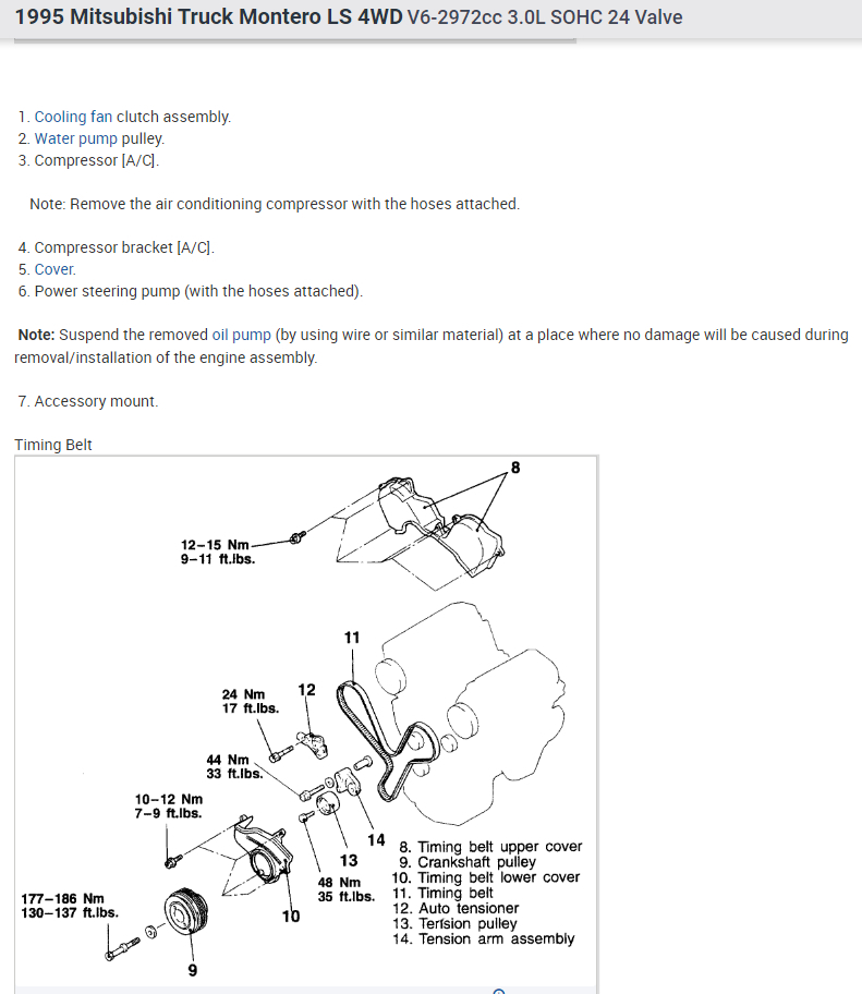

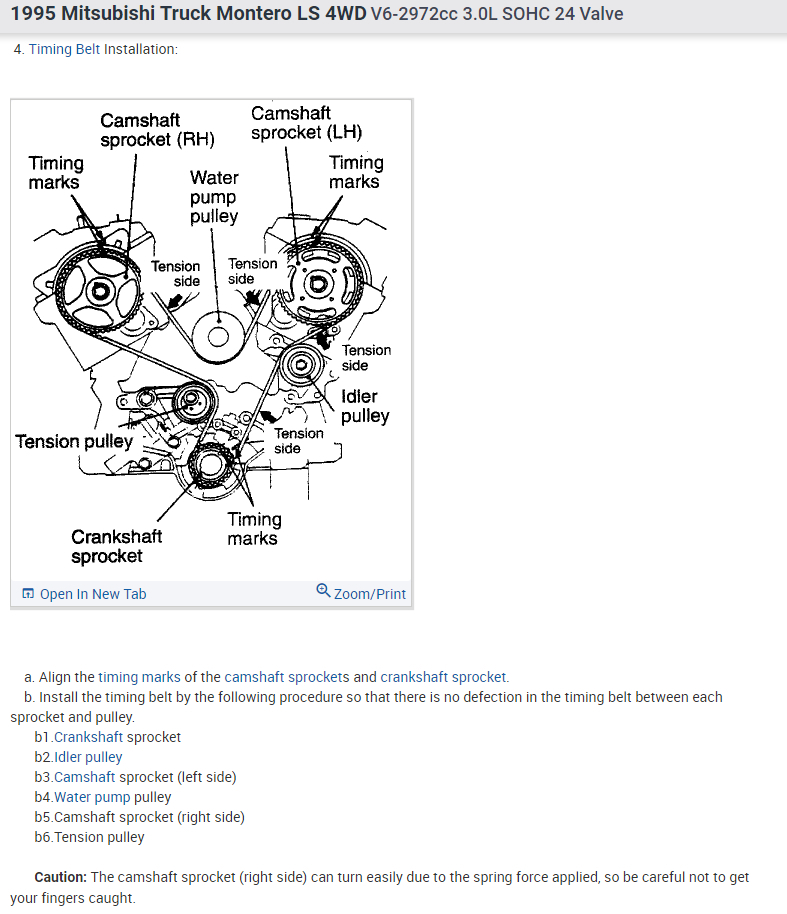

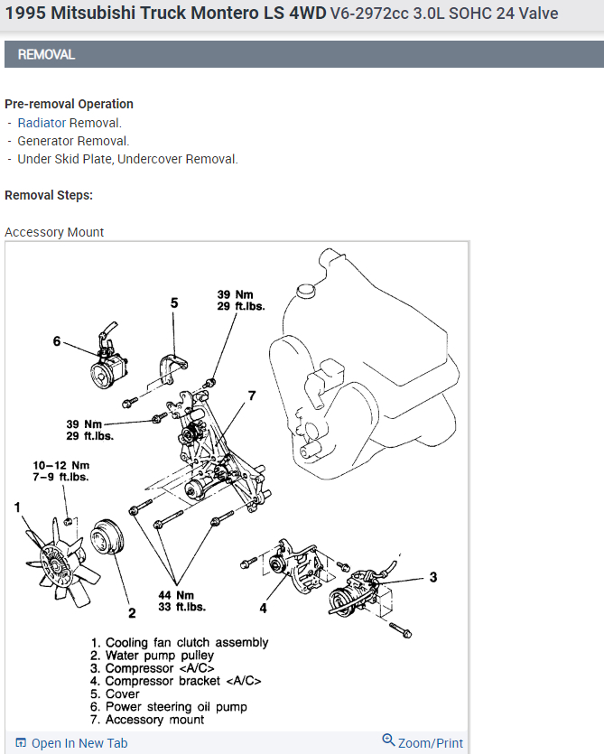

On an interference engine if the timing belt breaks during engine operation, it is more than likely that the valves got bent at the least. It could also damage the engine.
Since you have a hard spot when you turn the engine, you could have bent valve(s).
Only way to know for sure is to take apart the cylinder head and take a look inside.
https://www.2carpros.com/articles/how-a-cylinder-head-works

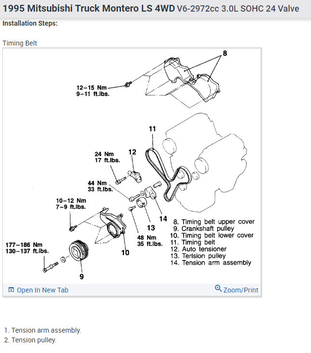

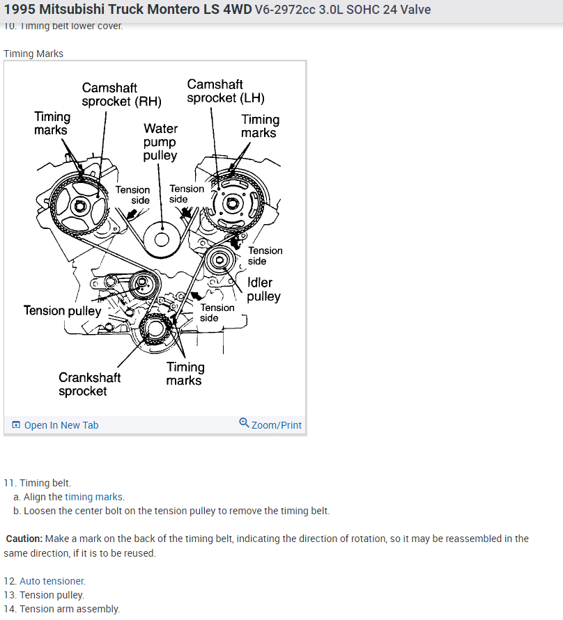

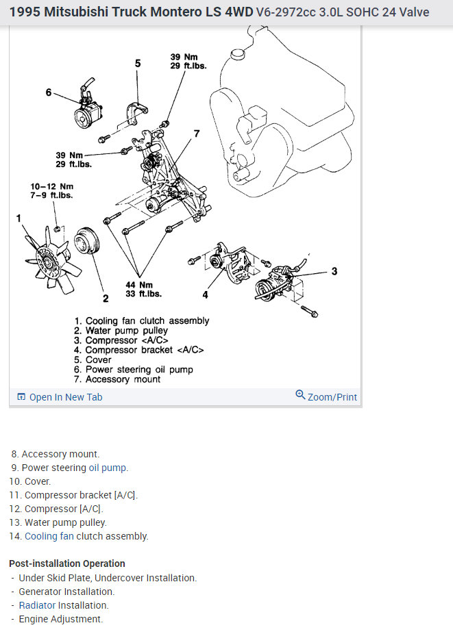

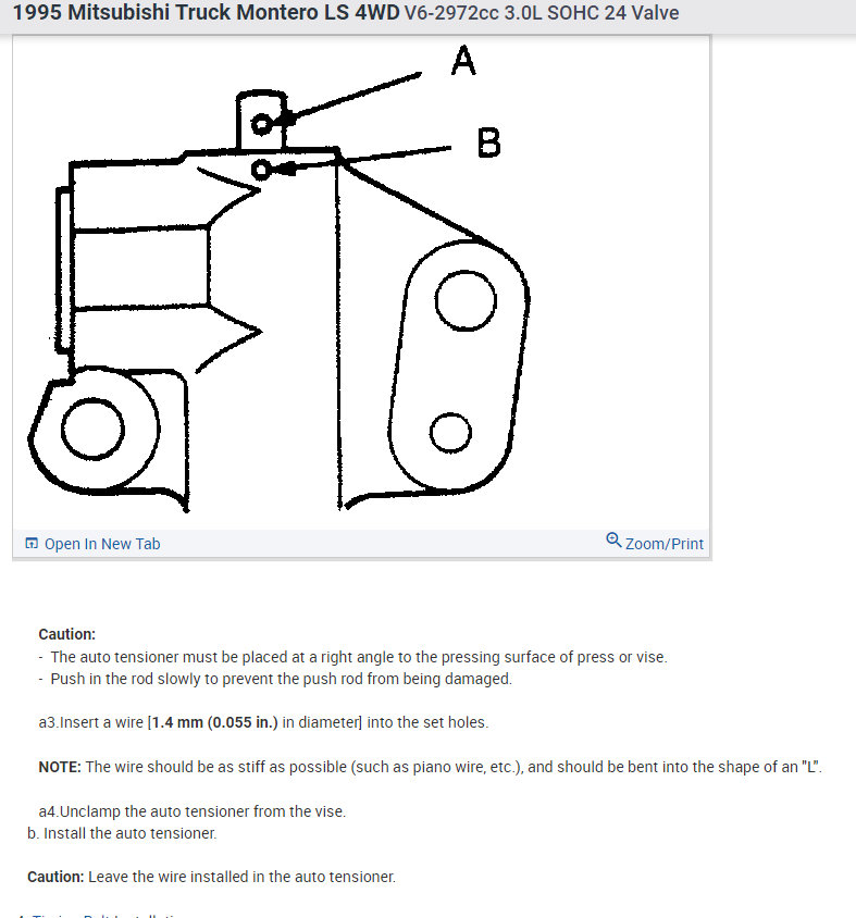

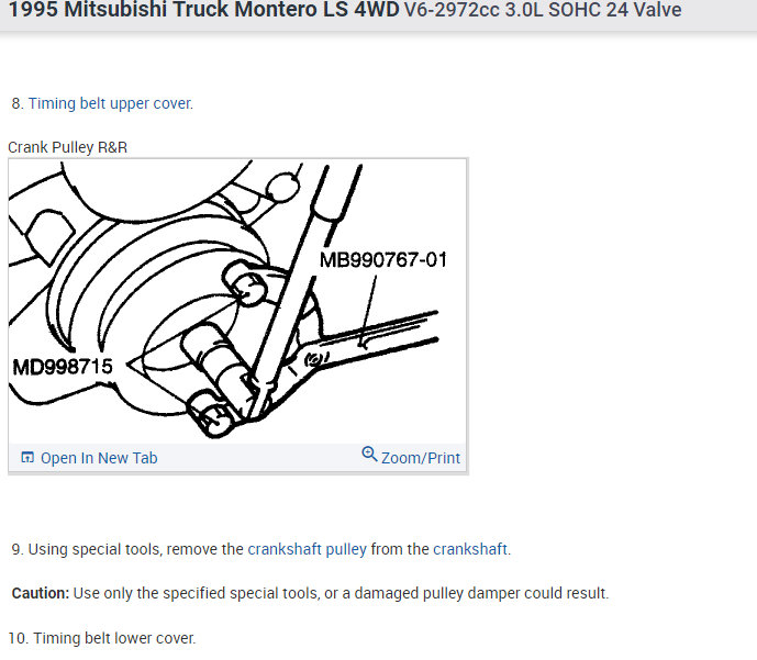

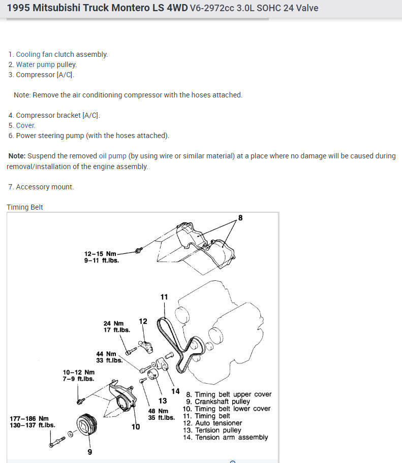

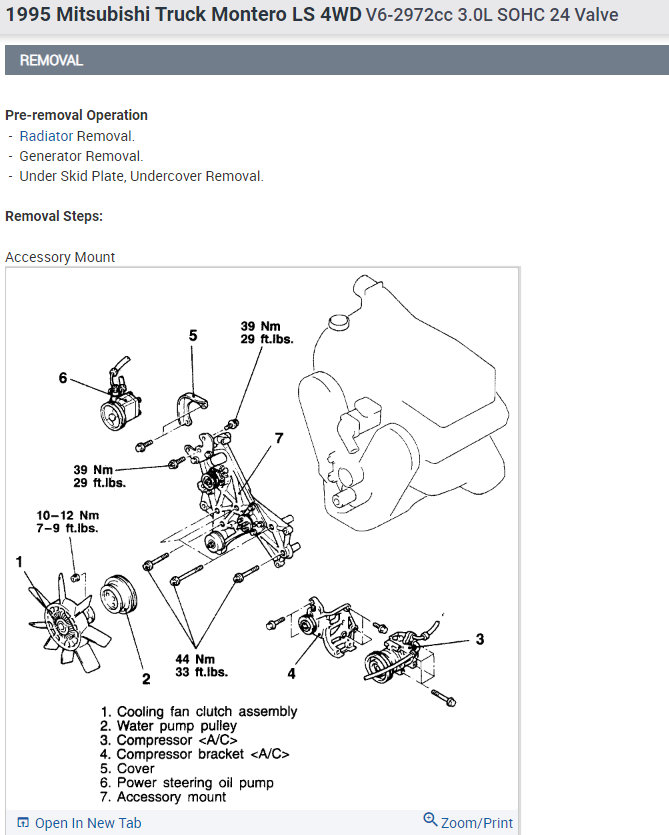

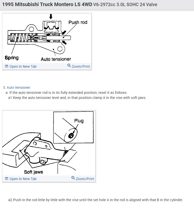

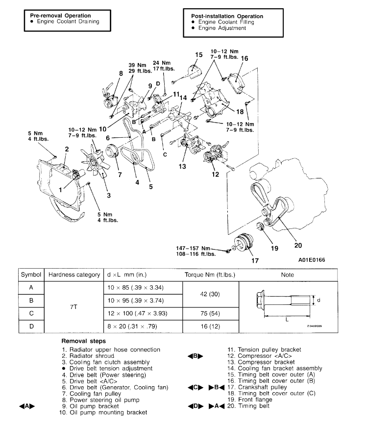

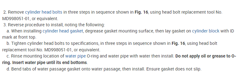

I have attached the cylinder head removal and timing belt replacement instructions for your reference.
