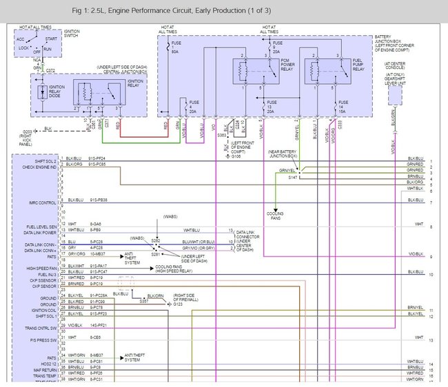

Im trying to locate the fuel pump driver module in my car. Ive troublshot the whole fuel system except for this module. I checked where it should be on the 2000 model but no luck. Ive also tried calling ford but they dont know either.

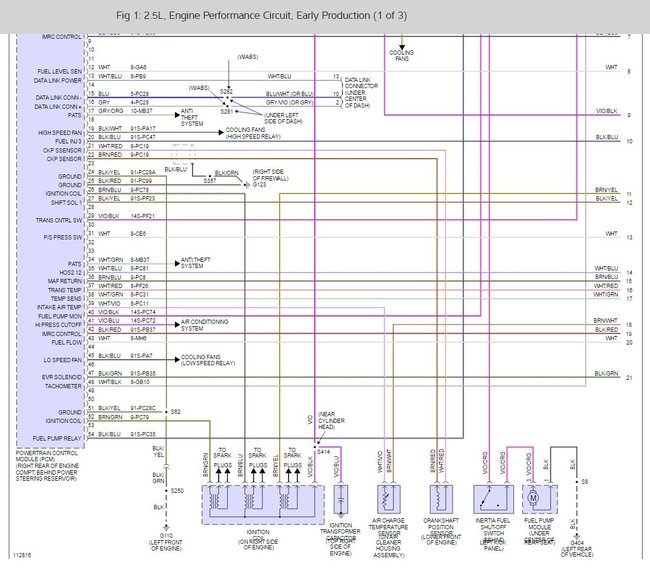

There is no fuel pump driving module just a relay here is a wiring diagram (BELOW) and a guide to help you test it.
Please run this test and get back to us so we can continue helping you.

Fuel pump itself is in the fuel tank. Fuel pump relay is at left front corner of engine compartment, in the battery junction box. Also check the fuses and the fuel cut off (inertia) switch, located behind the left kick panel.

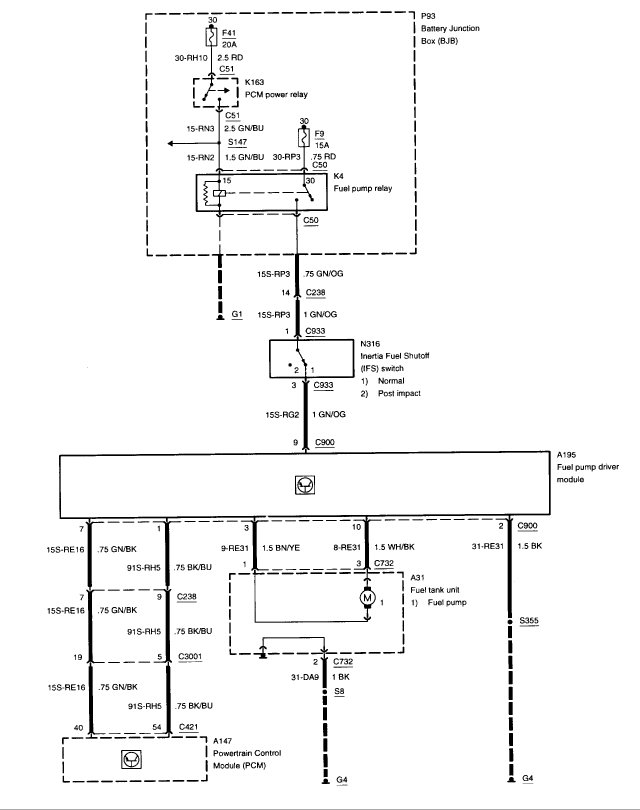

The wiring diagram supplied only applies to vehicle built before May 24, 1999. If it was built after that date, it does indeed have a Fuel Pump Driver module in addition to the relay, but that was only used for a couple months in that model year. You can tell which system you have by checking for a fuel rail pressure sensor. If it has one, it also has a FPDM. I suspect yours does not.
