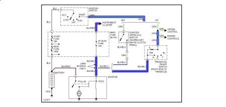

My 99 626 won't crank. Bat. Is good. It is like the car is in gear. I have tried N and nothing.

Could be the starter, transaxle range switch, ignition switch and starter signal fuse 10amp.
