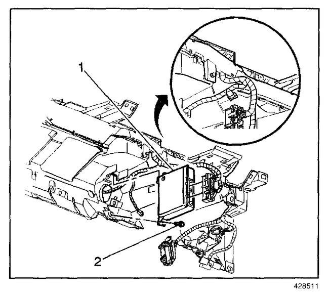

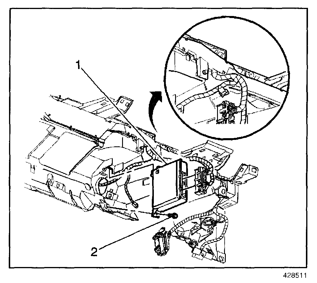

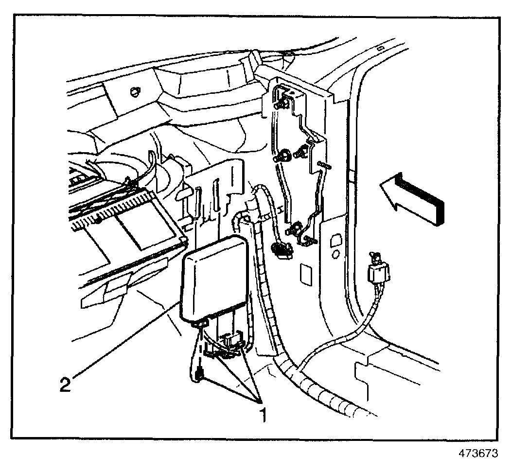

Car starts then shuts down. Location of the SLE body control module needed.
Friday, June 5th, 2020 AT 6:36 PM
  • 108,300 POSTS
There are three different ones. I attached pics for you to see. However, usually a body control module isn't the cause of a start and then stall issue. Have you checked for diagnostic trouble codes, fuel pressure, crankshaft position sensor and so on?
2002 Pontiac Bonneville V6-3.8L SC VIN 1
Components
Vehicle Powertrain Management Relays and Modules - Powertrain Management Relays and Modules - Computers and Control Systems Body Control Module Locations Components
COMPONENTS
Dash Integration Module
pic 1
- Behind Right Sound Insulator
Instrument Panel Module
pic 2
- Under Dash, Left Side
Rear Integration Module
pic 3
- Behind Rear Seat
