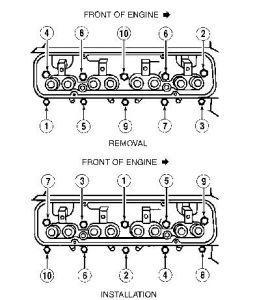

Do you have a head bolt sequence diagram for a 1997 Land Rover Discovery?

Torque bolts to 15 Ft. Lbs. ( 20 Nm )
