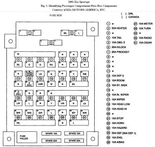

I have no gages reading, no tach and no speedometer. The motor starts fine but when I drive
off no gages are working. What could it be?

It could be a blown fuse. Check fuse # 27 ( Meter 10A ).
