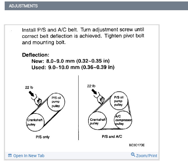

Loosen bolt in center of tensioner pully back off adjusting bolt position belt tighten adj. bolt till belt deflecys 1/2 " tighten pully bolt

How do you change the air conditioner belt on a 2005 Kia Spectra?
Jul 21, 2020 at 2:05 PM (Merged)
  • CAR REPAIR CONTRIBUTOR
  • 54,350 POSTS
Yes there is a tensioner that will need to be released. Here is a guide that will let you know what you are in for when changing the belt.
Let me know how to goes, we are here to help.

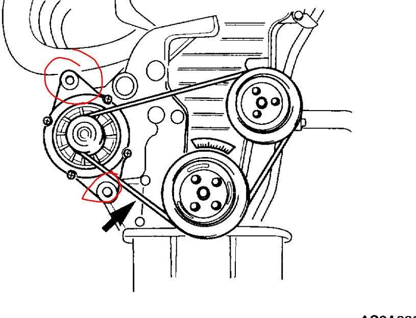

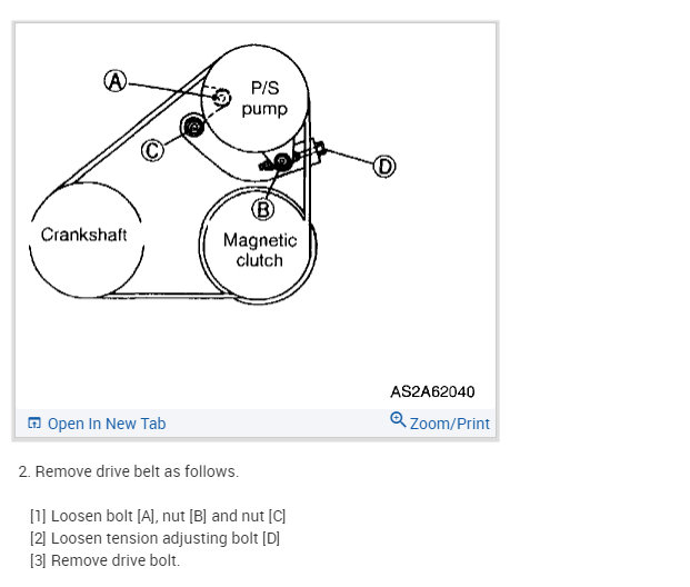

DONALD PEARCE
So I have to remove the power steering belt to get to the alternator belt? How and what boots do I remove?
Jul 21, 2020 at 2:06 PM (Merged)
Yes. Looks like that one comes off first. Here are the adjustment bolts on the power steering pump. Once that is off, you loosen the generator bolts that I circled. You don't remove the bolts. Just loosen them so you can move the generator to take the tension off the belt.

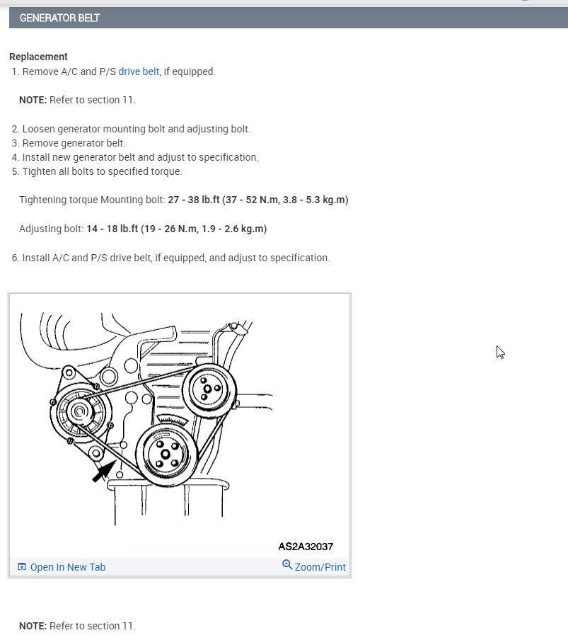

I need to know how to change an alternator belt on a 2002 Kia Spectra. Any advice would be great. Thank you.
BLUELIGHTNIN6
  • 16,542 POSTS
REMOVAL: Remove the A/C and power steering pump belt, if equipped. Loosen the alternator mounting bolt and adjusting bolt. Remove the alternator belt.
https://images.2carpros.com/forum/automotive_pictures/261618_0900c15280028466_2.jpg
INSTALLATION: Install the alternator belt and adjust, as outlined earlier. Tighten the bolts, as follows: Mounting bolt: 27-38 ft. lbs. (37-52 Nm) Adjusting bolt: 14-18 ft. lbs. (19-26 Nm) Install the A/C and power steering pump belt, if equipped. Check the belt tension and adjust as necessary. Thanks for using 2CarPros.com!
