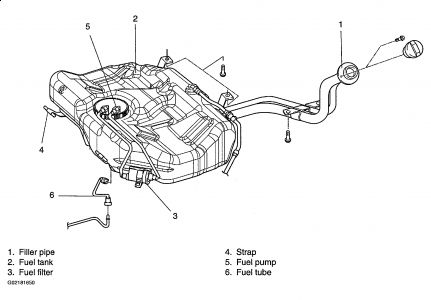

where is the fuel pump located at and how do I get to it
Monday, April 13th, 2009 AT 10:50 AM
DAVE H
MECHANIC
13,383 POSTS
Remove rear seat.
Remove fuel pump cover, and then disconnect fuel pump connector.
