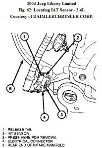

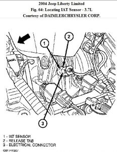

I need to know the exact location of the IAT sensor.
Is it the one on the tube between the air cleaner and throttle body?

Hello !!
here`s the location and removal procedure.
Good Luck!!
BTW Thanks a Lot for Your Donation!
Any other question we will glad to answer it !!
2.4 Liters Engine:
3.7 Liters Engine:
