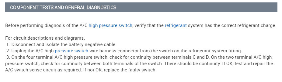

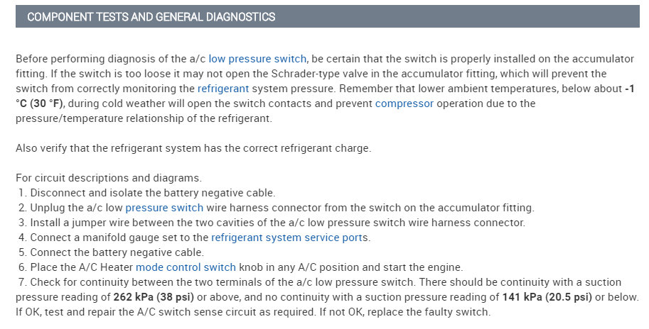

If the system checks out full, run a jumper wire to the compressor and see if it runs if not. If the compressor doesn't start bypass the high pressure switch too, if it still dosent start make sure all fuses are good then swap out the compressor. This guide will help
and
https://www.2carpros.com/articles/replace-air-conditioner-compressor
