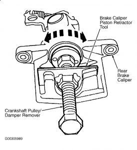

I would like to know what tools are needed to change my rear brake pads
Sunday, May 23rd, 2021 AT 12:59 PM (Merged)
DAVE H
  • 13,383 POSTS
Using the Brake Caliper Piston Retractor Tool fully retract the rear brake caliper piston into the caliper housing. See Fig. 64 .
https://www.2carpros.com/forum/automotive_pictures/266999_jag_105.jpg
NOTE:The left rear brake caliper piston retracts counterclockwise and the right rear caliper piston retracts clockwise.

CAUTION:Retracting the caliper piston may cause the fluid reservoir to overflow. Remove brake fluid spillage immediately from paint work with clean water.
Using the Brake Caliper Piston Retractor Tool (206-080) and Crankshaft Pulley/Damper Remover (303-588), Or a universal brake retract/rotate tool ..fully retract the rear brake caliper piston into the caliper housing. See Fig. 64
Using the Brake Caliper Piston Retractor Tool (206-080) and Crankshaft Pulley/Damper Remover (303-588), fully retract the rear brake caliper piston into the caliper housing. See Fig. 64 .

Fig. 64: Retracting Rear Brake Caliper Piston
https://www.2carpros.com/forum/automotive_pictures/266999_jag3_1.jpg
