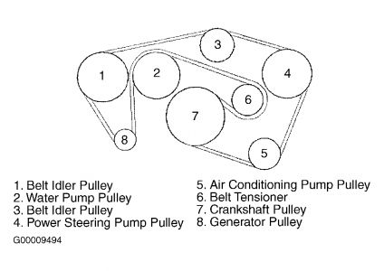

manual on how to install new drive belt

Release tension from tensioner .. remove old belt .. install new belt
